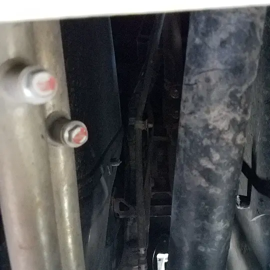

Now that the talons have been out for about 2 years or better according to the owner's manual you should do a coolant change at 2yrs. Has anybody done this? Is so can you show where drain plugs are? Thanks

Honda put drain bolts in the coolant tubes. Be careful to make sure there is no air in the system. There is a air blead on or near the thermostat housing.

View attachment 275721 View attachment 275722
Thanks for the pics. Is there a procedure to bleed the air out? Like open bleeder plug while filling until air is removed? I'm just guessing I don't know.
