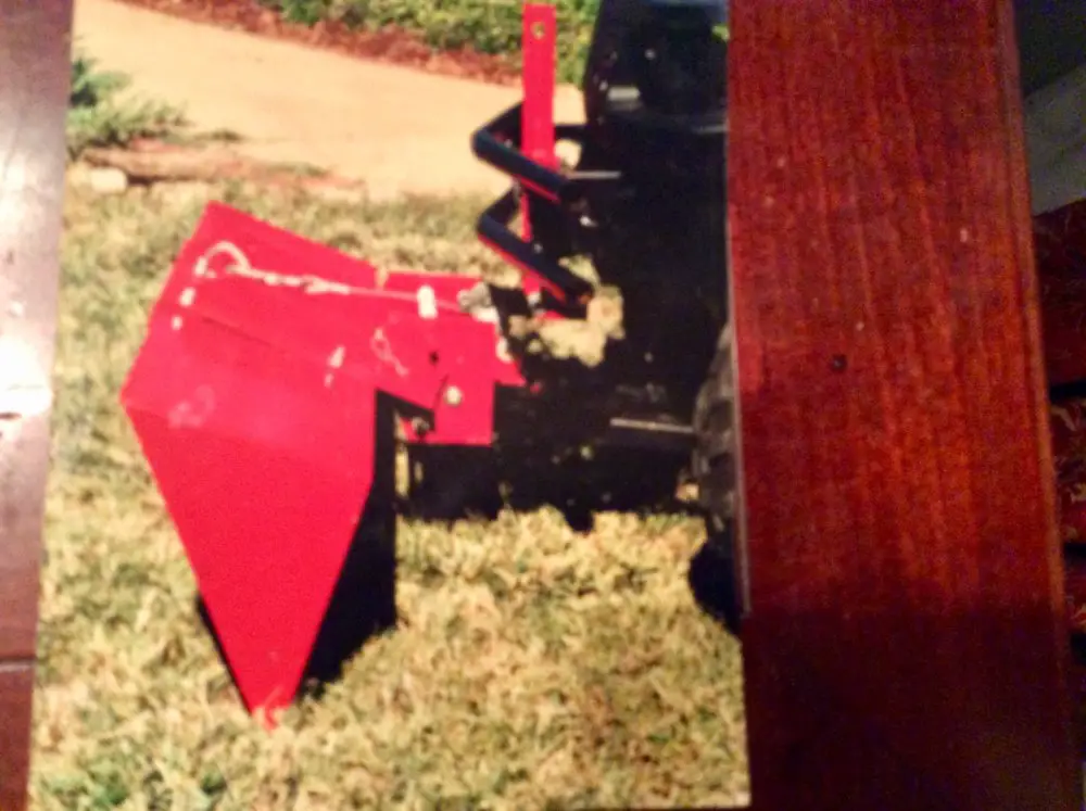

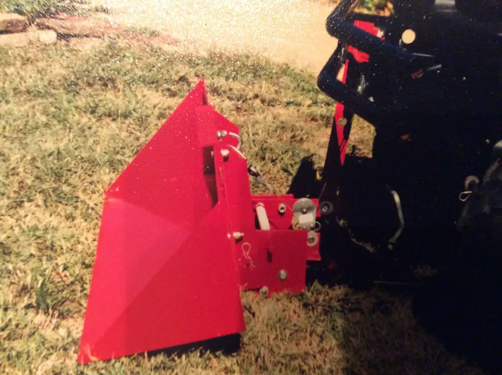

Nice skills, your quick connect is similar to a polaris belly mount I have. Fyi, for another project, made a bucket to switch out with the blade. Had to experiment with side brackets and pulley placement to lift and tilt bucket up on winching in. Later added pendulum legs at bucket/arm mount (no pic) to allow controlled dump while bucket was raised, by spooling out winch. Swinging legs eliminated the verticle height holder (piece at fairlead). Release winch, drive forward and legs swing back to lower bucket to scoop. Just sharing a fun project.

Nice skills, your quick connect is similar to a polaris belly mount I have. Fyi, for another project, made a bucket to switch out with with the blade. Had to experiment with side brackets and pulley placement to lift and tilt bucket up on winching in. Later added pendulum legs at bucket/arm mount (no pic) to allow controlled dump while bucket was raised, by spooling out winch. Swinging legs eliminated the verticle height holder (piece at fairlead). Release winch, drive forward and legs swing back to lower bucket to scoop. Just sharing a fun project.
View attachment 121601 View attachment 121602
Thats an interesting concept.
That's pretty sweet. Never really thought about a bucket on the front but could see it being handy. I'm definitely gonna be building a set of forks for loading logs onto the deck of my bandsaw mill. I like the idea of the controlled dump and with a set of forks would allow me to gently roll logs onto the deck...

And it you need really slow contol, do a second pulley, but that was too slow for my needs.
