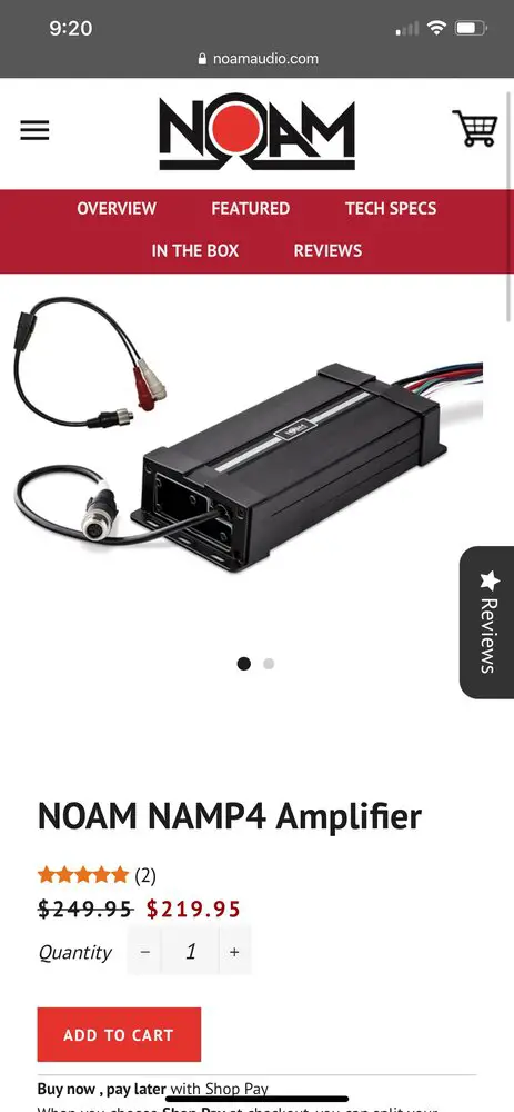

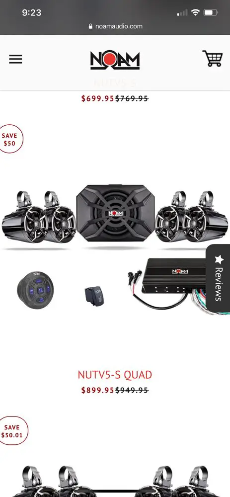

Just the audio. The rocker switch and Bluetooth controller stay lit up continuously. I recently noticed that Noam sent me a different amp than what’s pictured with the system. I asked about it and they said that isn’t the problem. I attached the pic of the system I bought and one of the amp that came with it. Could that be it? They said if I thought that was the problem I’m welcome to buy the amp and try it. Don’t want to spend $300 more if that’s not the problem.
View attachment 294072 View attachment 294073
Id still put a voltage reader in line and check it to be sure. Cross your T’s and dot all your I’s.Take pictures of your results so Noam cant tell you no. As i tell my apprentices, work smarter not harder.
