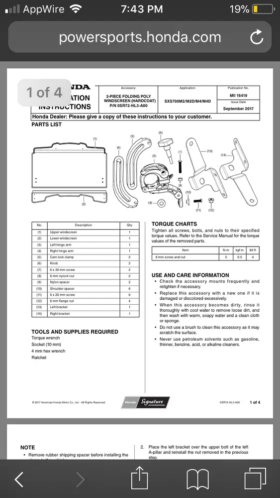

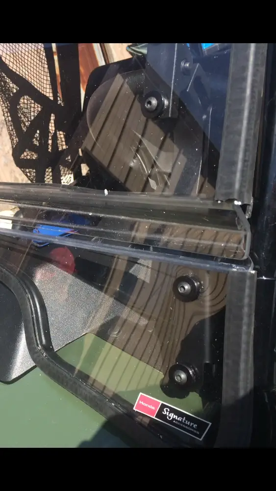

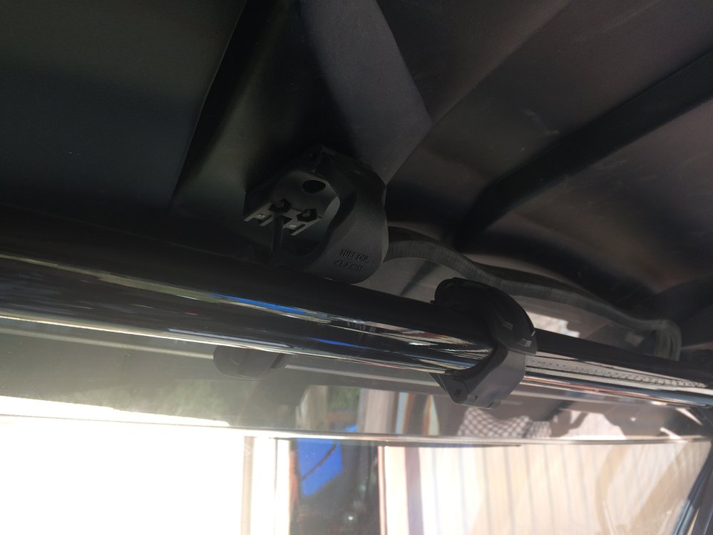

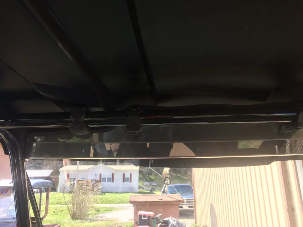

It’s a 700-2. I’m almost certain this thing is on backwards...someone show me some pictures of yours if you have the same set up. The seals came on the wrong side I guess? Tell me something people.
