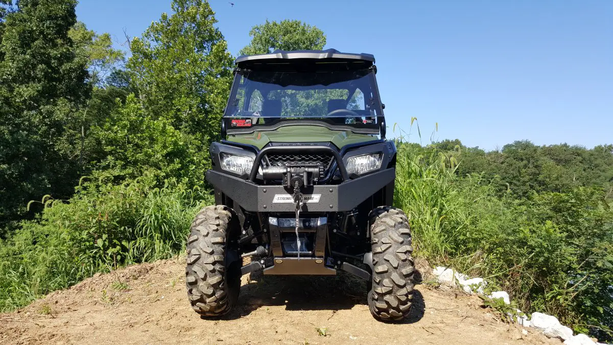

My KFI Stealth 3500 has a roller fairlead that came with the synthetic cable, use it on my P500 no problem:
Thats the exact winch my friend runs on his ranger. I noticed his rollers but ive noticed a few scratches on my rollers after using it once.

Take your rollers off and polish out any scratches and you should be fine.

I may do that. The only reason I would even consider keeping it on instead of the hawse is the extreme angle that the winch line is in.
