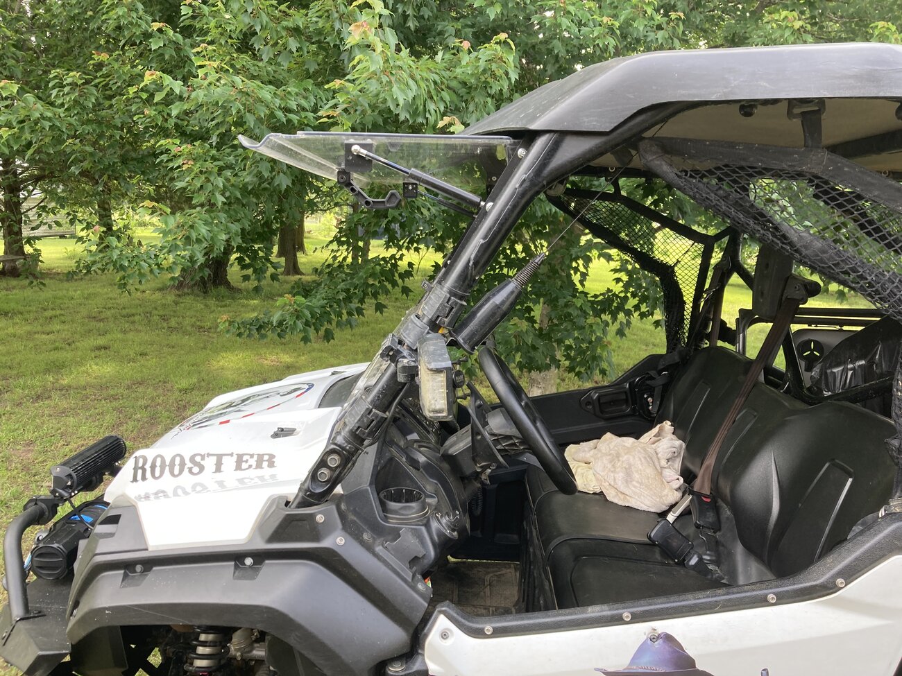

Wanting to install Ranch Armor extended roof along with SuperATV glass windshield. If you happen to have an idea whether or not they will or won’t fit I’d greatly appreciate it!
yes it will i have the ranch armor roof on my p-5 and the SATV flip up windshield works perfect with a light bar look at my picture
Awesome! thank you! ordered :)

hey just a option when i installed the roof the mounting clamps that came with the roof were crap from ranch armor (u would think for 1600 + ) so i ordered the nilight -90021d mounting bracket kit ( 4 clamps) for lights off amazon ( $20.00 ) i saw some ones roof done this way in person and it was way better then factory so i bought 2 sets and put 6 on the roof and had a set to mounts lights so much nicer and quieter i think a very good upgrade !
