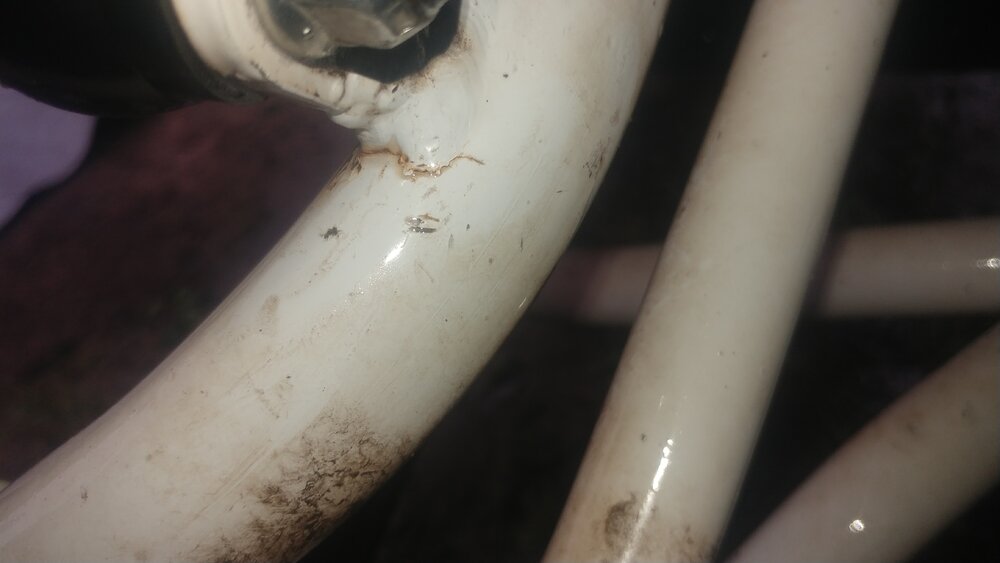

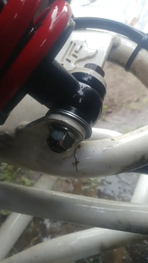

Well, this isn't good:
Hit my machine with the power washer, getting ready to install my new springs on the Fox shocks up front. Cleaning the front a-arms and looked at the right side upper arm, near the shock mount, and found a crack.
0922211739
Looked over at the same place on the drivers side, and found a smaller crack starting.
0922211740a
Contacted Jared at TTC, he's manufacturing and rushing two new upper a-arms to me asap. I'm a little concerned about how / why this happened, waiting for more feedback. My machine is certainly not on the high-end of the abuse-o-meter, mostly trail riding under 20 mph, hitting some bumps and ruts here and there, climbing some stuff. No rock bashing, no jumping.
3 months / 1500 miles.
That sucks man! At least they are taking care of the issue for you. Hope the new ones work out better 👍

That’s why I don’t clean my machine before I work on stuff!! Between the mud falling in my eyes and the mud on the a-arms, I would have never noticed cracks!
Im glad they are fixing it so quickly.

As a follow-up, Jared at TTC did send me new front arms asap, and they're much heavier duty. I learned that all builds going forward are made with the heavier material.
I ran the new ones with no issues last season.

Mine cracked in the exact same place, Ive welded them back up a few times. Jared also sent me the thick tube boys, which im just now getting around to installing a year later lol!
