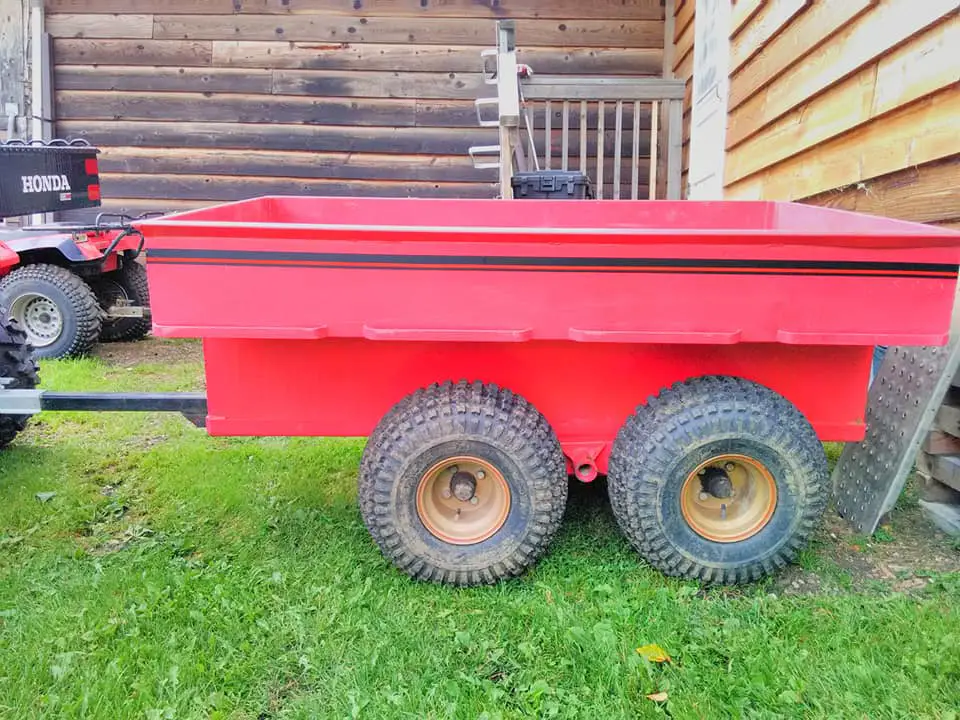

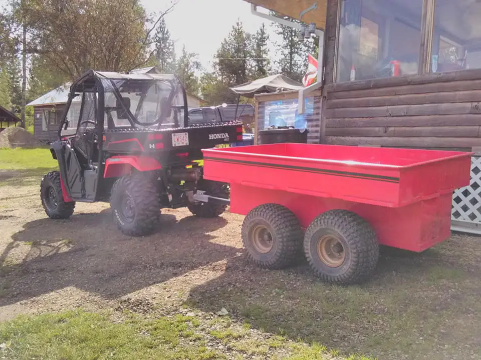

Had some extensive sticker pealing today. Removing some old silver decals on my pull behind, scratched and chunks missing. Applied a new black stripe with red pin stripe to match up the P500. Excited to get into hunting camp... about a month and a half away. Next few weeks will be going through all the machines and gear... Fun times!

Looks good. No trouble with the hitch binding at the base of hills or over the top of a hill or in off camber transitions? I've considered putting a swivel and flex joint in if I ever get around to building a trail trailer. Curious if I've just been overthinking it.

I actually put new radials on, maxxis bighorns all at 4 PSI, 2" bigger in circumference (1" on the ground) and 2" wider. The extra ground clearance is really nice, going over big logs is a piece of cake. The trailer hitch bar, is extended another 16" and has walking beams. Overall it pulls really well, no hangs up.
