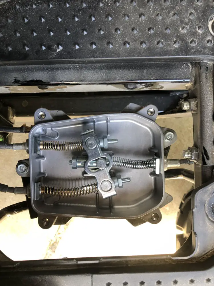

So, as you know; I picked up my 1000 on Thursday evening. On Friday put some miles on it. Saturday went to do yard work and noticed that turf mode never fully engaged. Well, long story short I found the video, adjusted the cables without any problems and works perfectly. BUT look how far out these are straight from the dealer!
This is of course before the adjustment

Very simple! Took less than 5 minutes. I chose not to jack up bike though. Just made sure it was locked
