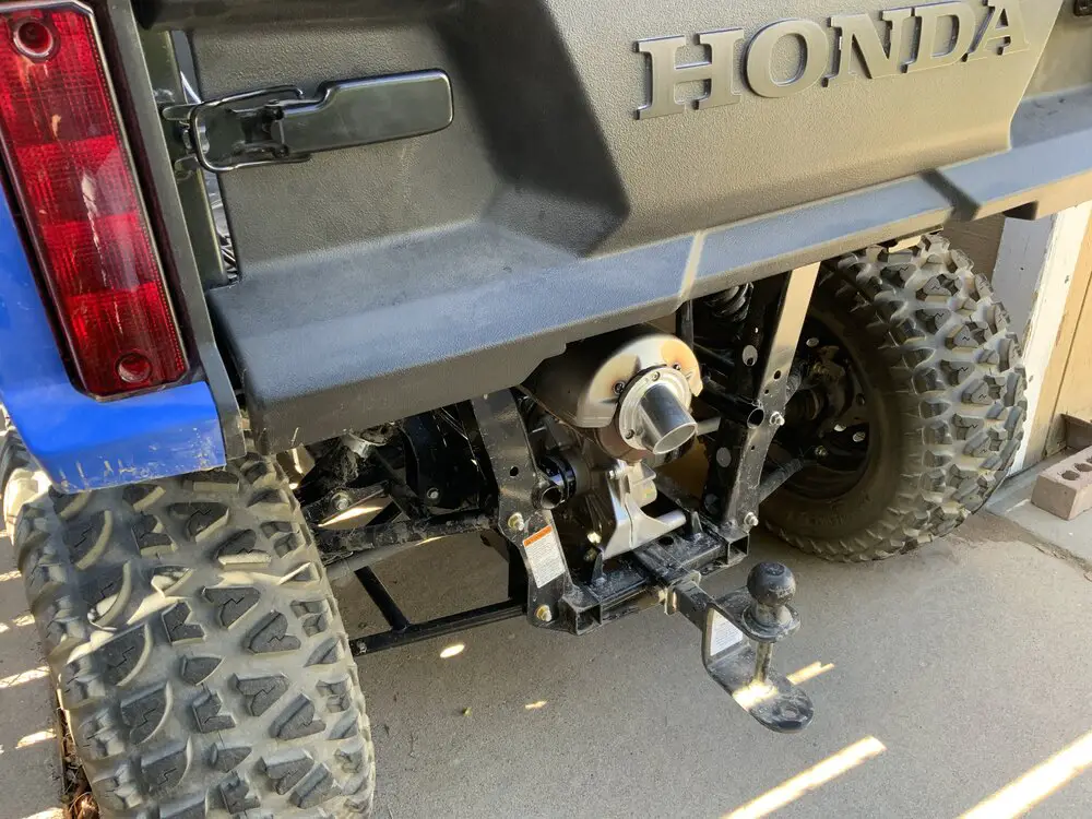

Did this mod yesterday. With the hole saw trick Lee put on here, it took maybe 30 minutes. I spent more time working the shield back on. Really REALLY happy with the results. Thanks to Jay_Man and Lee for their posts. Highly recommend.
Oh and I too forgot to put the screen in first time—easily forgoten when you get excited over how everything goes in smooth.
