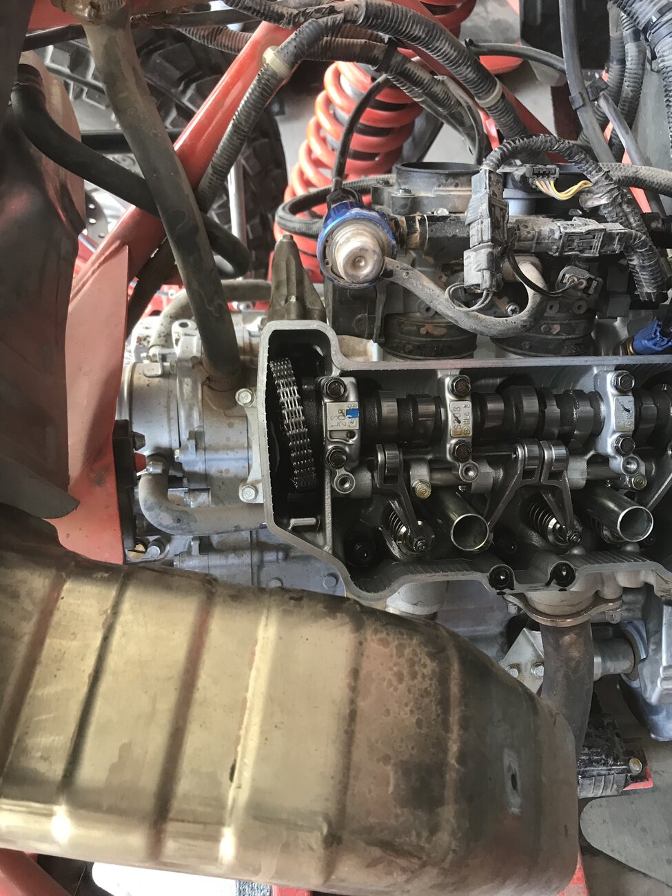

Maybe it was just bad luck on my part, but recently I changed the Camshaft in my 2020 Talon FLV. Following the service manual to the “T” I retorqued the bolts to 15ftlbs and applied red Loc-tite. I made it 4.1 miles before both bolts let go. I’m not sure how it didn’t destroy a valve or piston. Or how the bolts didn’t get into the DTC side of the case, but it didn’t. Nothing in the manual states that these are one time use only bolts or torque to yields. So just to share a bit of information, IF YOU CHANGE YOUR CAM REPLACE THE SPROCKET BOLTS AS WELL.

Pics?
18,865
108,207
Here are the pictures
