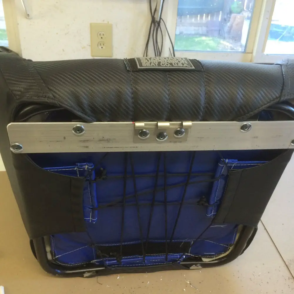

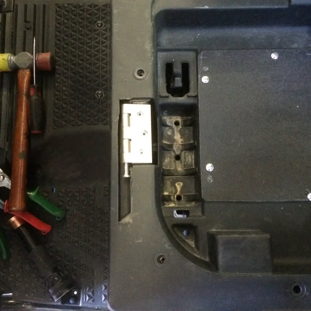

Thank you for your for your replys. The seat mod and the power steering made all the difference in comfort for this unit. I am 6ft and was a little worried about leg room when I ordered the seats, but with a little trimming and modifying the honda plastic seat pans, I was able to create enough room. seats aer very comfortable and the suspension design absorbes the bumps.
I used a 4in stainless removable pin hinge at the front of the seat so the seats can be tilted forward for access under the seat. The seat can be easily removed by tapping out the hinge pin.

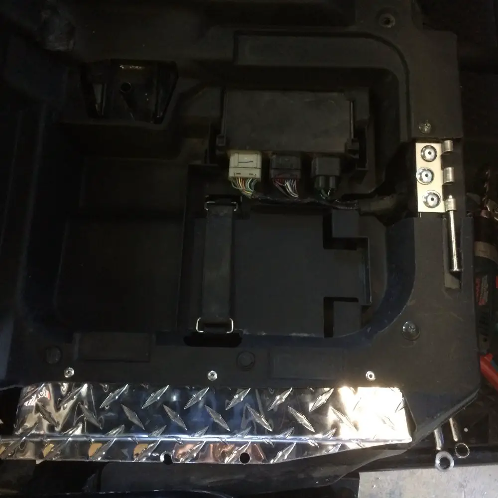

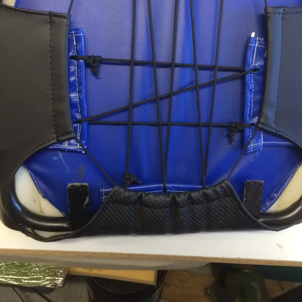

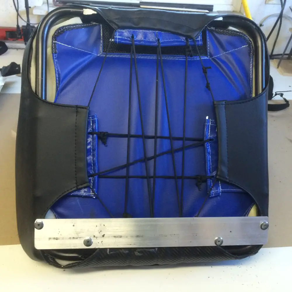

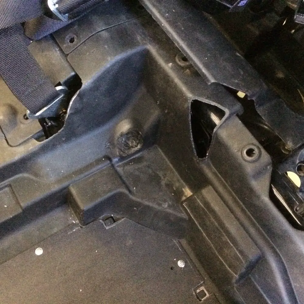

Pitctures of the seat modifications and seat pan mods. Also the right side loop bar needs to be moved out about an inch or so. Remove the bolt on the loop lower bracket and use a 2x4 to force the loop out and drill a hole in the bracket for reattachment.

I drilled a 7/16 in. hole through the approximate center of the headrest plate,( headrest is removed as it is no longer needed) then bolted both seat harnesses with a spacer to the plate. I used a #8 hard 7/16in. bolt to attach the harnesses.
