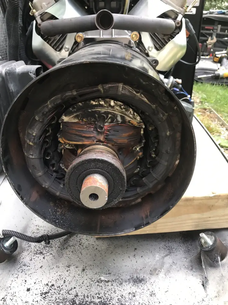

Just for s***s and giggles. Just so happen today to be replacing a standby rotor and stator 20kw that was overloaded. Customer said "worked fine for about a year!" The house had 4 ac's and not load shedding hooked up to the transfer switch. 2,500$ repair for someone that didn't know what they were doing

Wow looks crispy... we're basically full elec, with well pump, and got load shedding on a 20kw but the only time it sheds anything is if my wife tries to fire up the dbl oven while both HPumps, HP WHeater, and dryer are running. It's #5 module and gets shed PDQ since it's a 10kw draw alone.
Those ACs draw some juice. We were gonna go 100% offgrid solar but the battery storage for the HPs was ridiculous.
