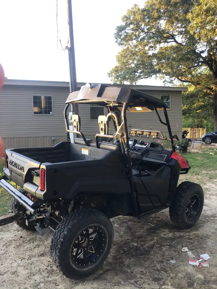

I run a truck tire on my 700 same size all 4 corners but my tires measure 29 inches tall and are 15 inch wheels I have probably 3000 miles on highway hardly any wear at all and they pull good in the fields to im sure you can a truck tire in a 14 wheel
Do you have a lift kit? I have a 1000 Deluxe with 8000 miles. I drive it daily and am in need of new tires. i run low speed gravel and 50 mph blacktop. very little mud .Any recommendations on tire with no lift or spacers?
thanks,
I have two inch shock spacers they clear just fine I run a 30 inch zilla when go off road you can get shorter truck tires in a 14 inch wheel I got mine from tirerecappers.com
