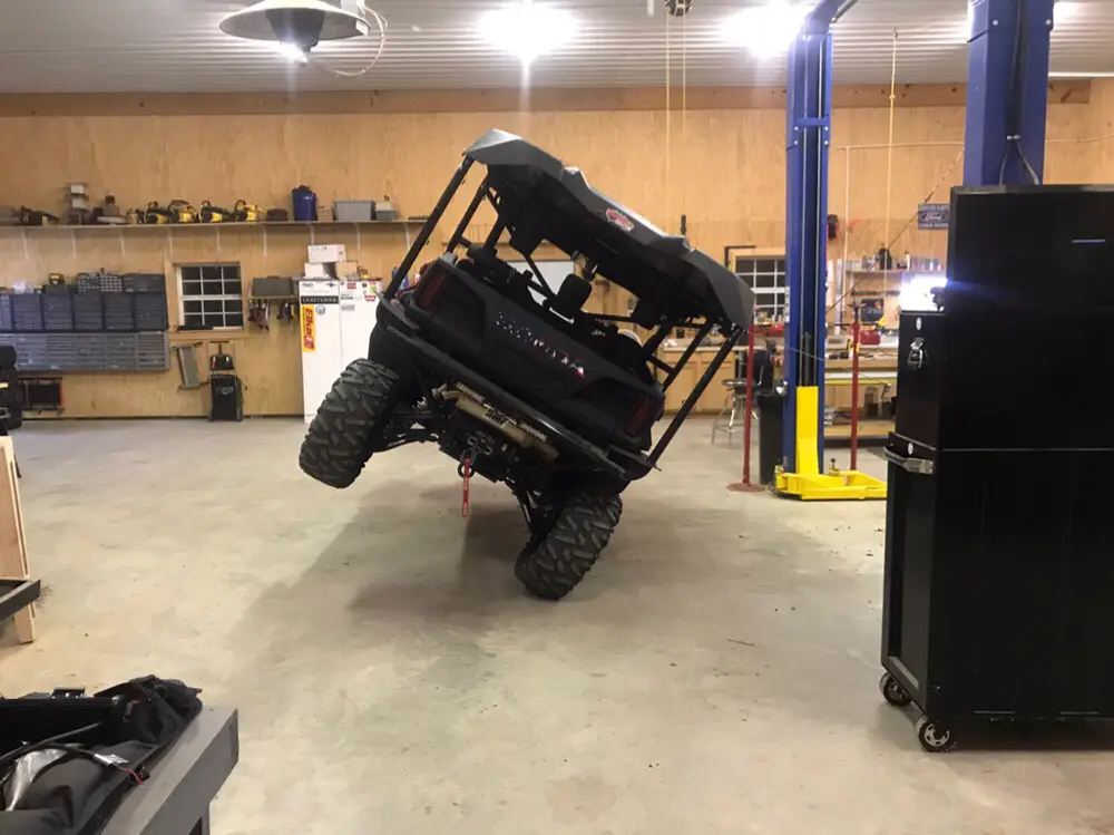

Just found the same situation. Completed first oil oil change and all was good for about 10 hours. Now found a small leak and it's coming from the DCT filter cover. Guess I'll get a new O-ring and open it up. Just to confirm, I need to drain the oil tank to replace this?
39,124
So to revive a dated thread...
You won't have to drain and refill. I went through something similar last week and tipped mine over to reduce oil loss.
