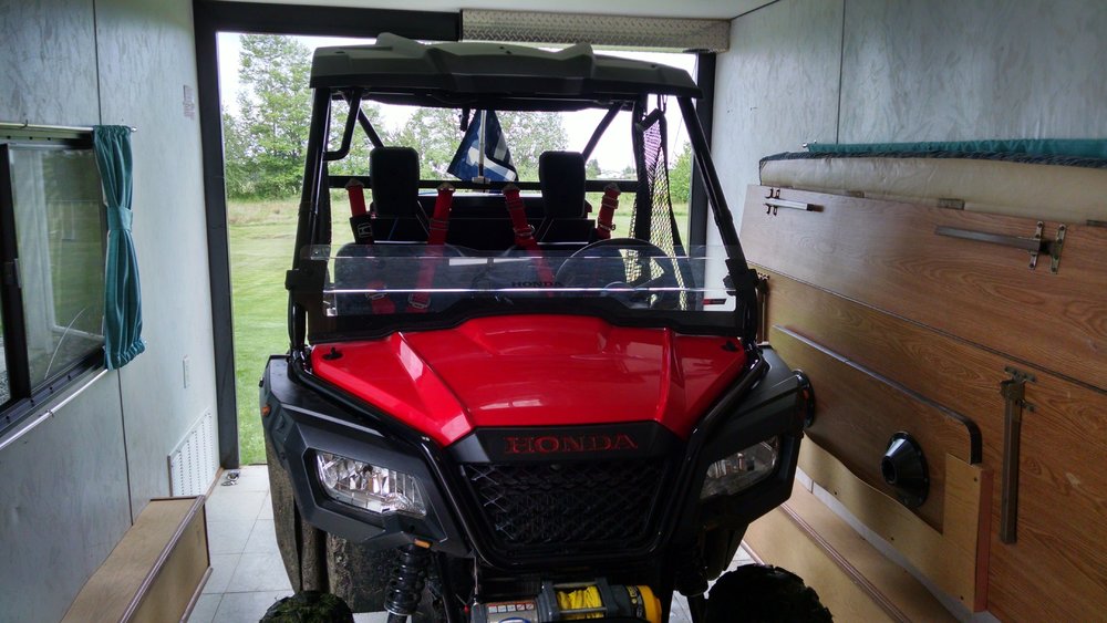

Prime Time Avenger 18th and 21th was on my list to measure but the closest one was in Hammond Mississippi, just so happen my wife wanted to go to Biloxi so we did, a 140 miles further was Hammond Ms. so, we brought home a 2016 Avenger 18th. Its 4618 dry (confirmed at the scales), can carry 3107 lbs and 24 ft total. It has a Murphy bed up front and the door is about midway too.
The p500 fits just right, except with 2 1/2 inches clearance each side, I have to climb thru front or the back of the p500 when its in its spot. I have to do this only because I wanted the emergency brake on to lessen stress on tie down strap and anchor points. But, this was overcome by constructing an emergency brake lever, attached to the nut on the threaded brake shaft bolt, in such a way I can operate while standing at the rear of the p500. So I drive it in, get out as soon as the rear tire clears the ramp, then push the p500 to the tie down spot, lock the brake from the rear then tie it down.
Something I did not expect, was the extra doorway clearance.The p500 roof is 77 inches tall with 26 in tires, the doorway opening is also 77" tall from floor to the mosquito net frame attached to the roof. I was very surprised that there are 3 inches of clearance as the tip top of the roof passes by, the position if the rear ties at this point are still on the ramp and lower than the floor.

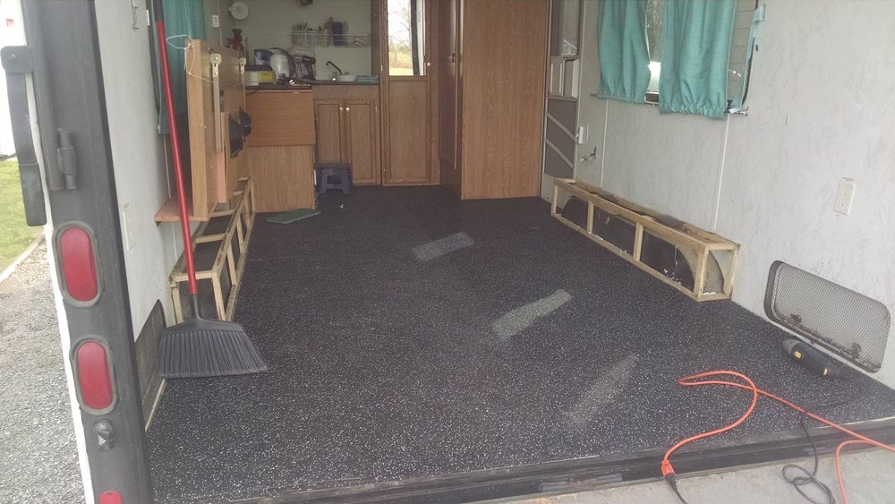

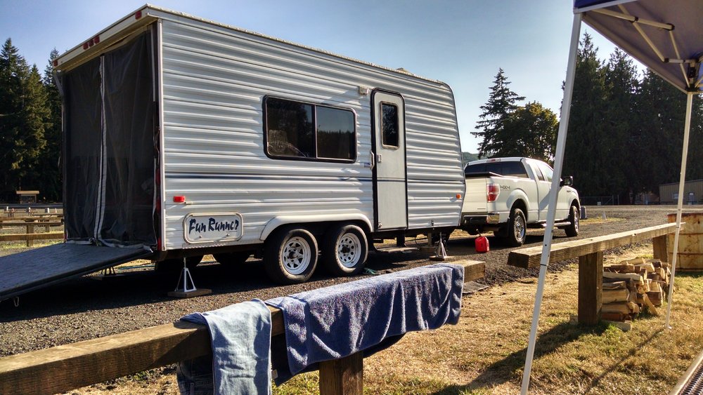

I was able to find a 2002 Carson "Fun Runner". A 18' ft toyhauler with sink,stove, refrigerator,toilet and a shower. It was a little bit "tired" inside ,but I've had fun fixing it up a little. They are out there . My 500 fits just fine. I use a Kolpin "Loc it tight" system to tie it down as there wasn't any good place to attach any tie downs. Right now, I'm installing new flooring Ztrailer1 Toyhauler IMG 20180409 112451299 IMG 20160824 175515693 HDR

I was able to find a 2002 Carson "Fun Runner". A 18' ft toyhauler with sink,stove, refrigerator,toilet and a shower. It was a little bit "tired" inside ,but I've had fun fixing it up a little. They are out there . My 500 fits just fine. I use a Kolpin "Loc it tight" system to tie it down as there wasn't any good place to attach any tie downs. Right now, I'm installing new flooring View attachment 72955 View attachment 72956 View attachment 72958 View attachment 72957
What did you use to color in the front HONDA logo ?
Thanks

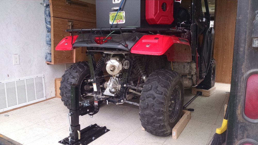

We actually fit our p500 in a 2018 wolf pup 17rp :)
Passenger front tire up on the wheel well, I built and frame that slips over it so less strain on the well. No mods to the sxs or the trailer to make it fit. Its tight but works great :) And the driver side door has room to swing open so I can walk out :)
We had the tiny toy hauler already and always had quads, never anticipated a sxs since it's a small trailer. But I saw the p500, looked and the specs and took measurements, went to the dealer and told them, I'm bringing my trailer, Fitbit fits, I will buy it. Now we have a 2020 p500 to replace my quad so our son can ride with one of us and the other can ride the other little quad. I actually added a harness in the middle and we have ridden 3 wide in the little p5 plenty of times ;)

I don't have a picture un fortunately. Will take some the next time I load it up. I haven't felt any issues with tongue weight. The engine in the p500 sits low and dead center like a big quad as opposed to alot of other sxs where its sits in the back. So when loaded, that puts the weight a bit more forward and centered. I also have a weight distribution hitch. But it all pulled just fine and wasnt unstable at all. My tow vehicle is a 2017 ram 1500 quad cab, 2wd v6 and does the job just fine. Our last trip was 157 mile treck one way :)
