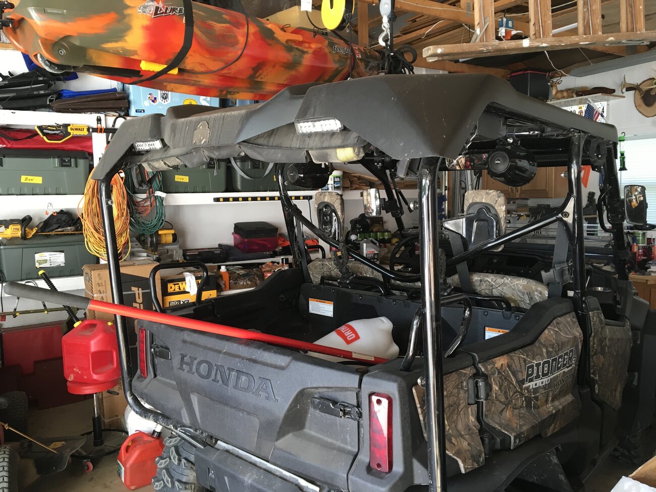

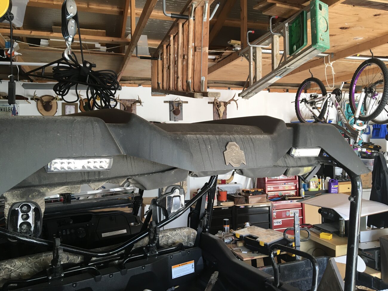

Here are a few pics. I pretty sure the rear window should tuck up under the roof and those lights will be in the way.
IMG 0263 IMG 0262
Reactions: Remington
39,294
266,444
View attachment 389910 View attachment 389911
You will either have to:
A: remove the lights.
B: notch out the SATV plexiglass where the light clamps are.
C: mount the light to the roof plastic.
D: mount the lights to the rear plexiglass ( not recommended)

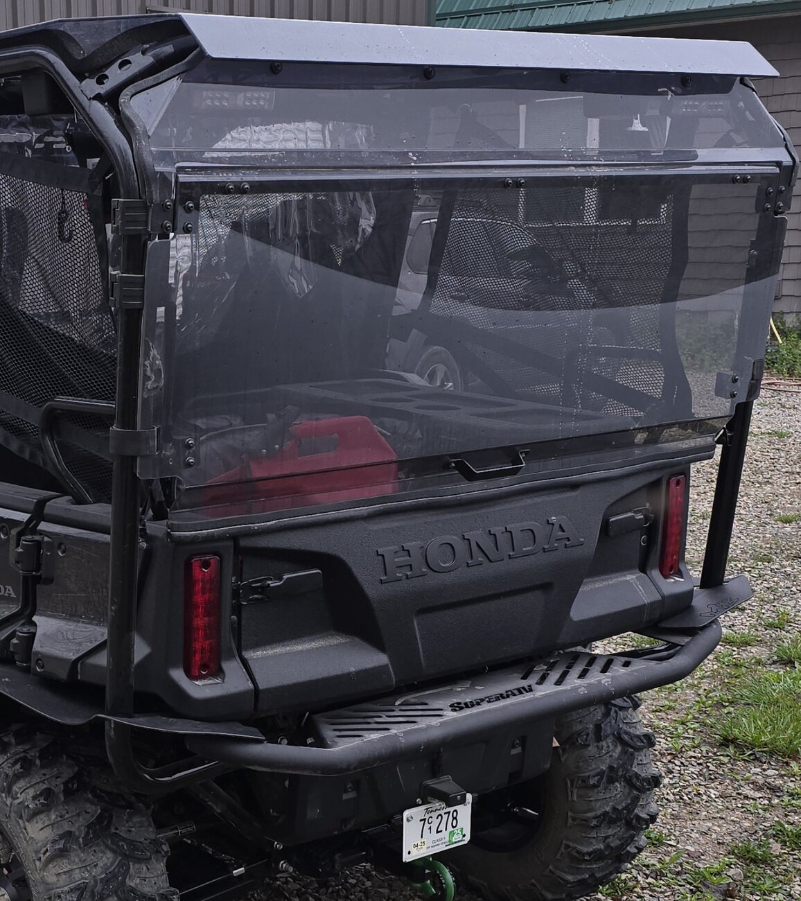

The only pic I have showing the rear lights. The are actually a little lower than they appear, and below the top of the roof line. You can see from the way the rear windshield mounts that OPs lights gotta be moved.

You may have to adjust them if the clamps are in our clamp locations, but I'm betting you can make it work pretty easy. It wouldn't take much to mod the windshield if you needed to notch it, but you may not have to as long as the light clamps aren't in our windshield clamp locations.
