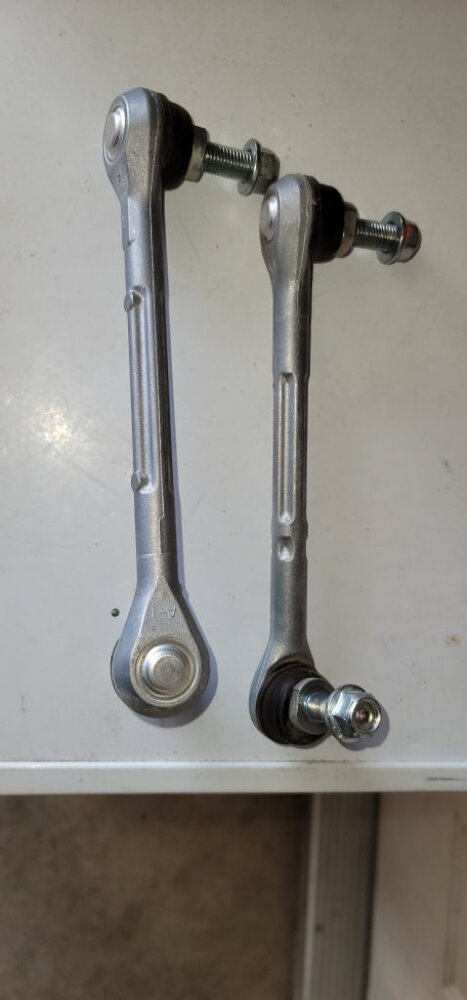

I looked at mine last eve and thought I can do this. So without taking the tires off I broke out a wrench and ratchet and started on one of the links. It broke free, but the damned nut wasn't moving. Then I tried to retighten it and it wouldn't tighten back up. Looking at both sides, it looks like the nut never moved that maybe it's just spinning on the bolt head end although I can't feel it spinning.
See I told yall this was a bad idea 😅 . This can't look any simpler, but yep I gave up. I am gonna run it to the shop and let my do all mechanic snatch it off unless someone can tell me what I should try next to get the bolt out of the link.
9,264
42,042
If your talking about the link out at the end, those spin like a tie rod end. You have to hold the center with a hex bit, or the flats on the back side (next to the rubber boot) with a wrench (preferred). They are locking nuts, so they will have some resistance all the way off.

Getcha some of this. Took me about an hour maybe an hour a half. Once I figured out it would be easier to get to the nuts if I raised the bed it went much smoother 🧐.
Thx for the help boys and girls. Much appreciated.
