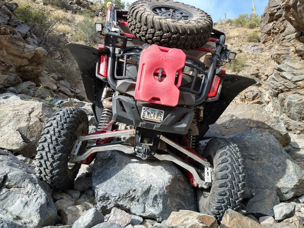

Lil_Steve
Lil_Steve
May 22, 2019
544
2,107
Gilbert, AZ
I believe @Lil_Steve has the adjustable Eibach SB but I'm not sure if he's had it long enough to comment? He also has the QD SB links.
I do have the Eibach adjustable sway bar and I've mostly run it in the middle position. I did harsh hard rock riding and crawling today with the sway bar disconnected. It is a compromise, the articulation was great but felt so much more "tippy" almost everywhere. I like to carry corner speed and it's unnerving with the sway bar disconnected. But disconnecting the sway bar was a nice option to have today.
IMG 20201121 134532215 HDR X2
CID
CID
Oct 27, 2019
5,083
22,833
SE Denver-ish
Cool photo, Dude. Thanks for the feedback. 👍
