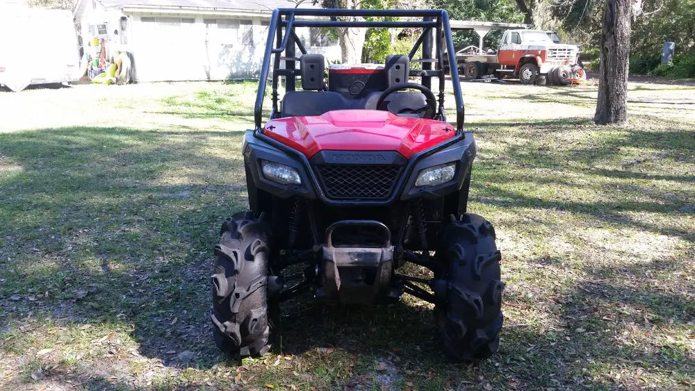

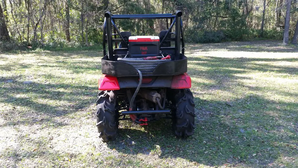

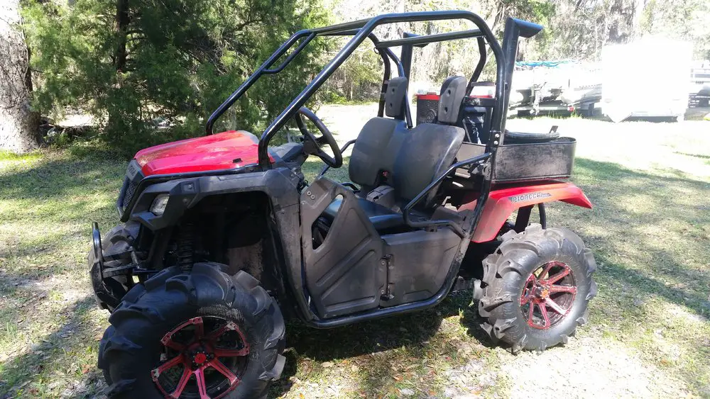

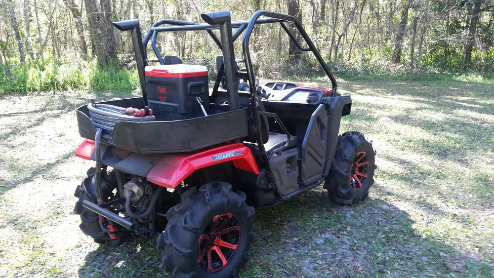

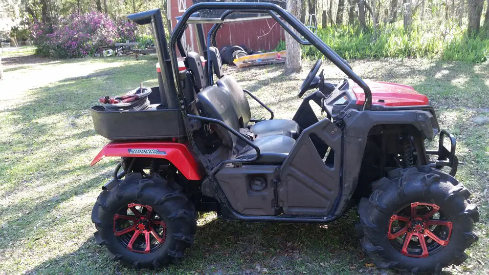

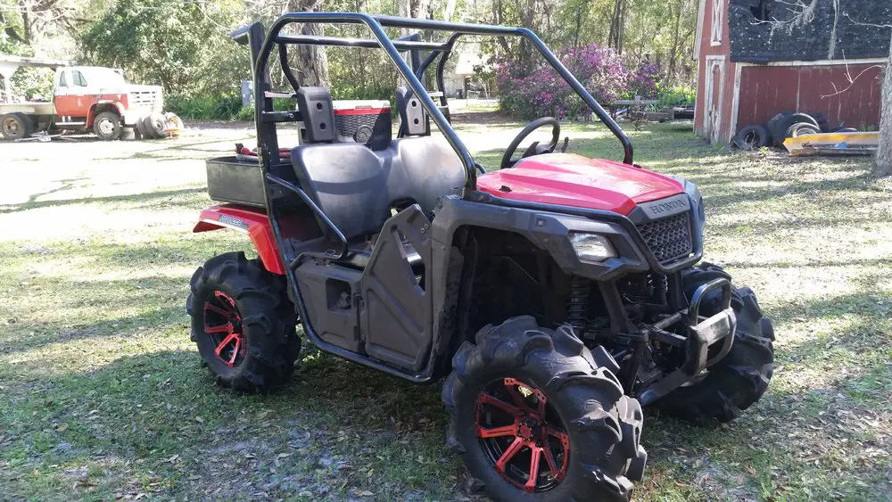

Well thats it in a nutshell. My rendition of a chop top. Now next weekend i should be able to start my new thread: P500 roof build! Lol i just gotta weld in the new brackets for the stacks and finish the diagonal bars where they bolt behind the seats. But overall i love the new line of the roof. This was a pretty time consuming mod considering i picked the easiest way to do it, at least in my opinion. Btw, please forgive how dirty my p5 is. Instead of cleaning it like i shoulda been, i was cutting and welding lol. I hope yall enjoyed it! I'll update the last of this next weekend and then move on to my roof. Take it easy!

I think it looks great BC , the chop you did is the perfect amount !
I won't be doing mine until after I get back from a Hatfield Mcoy trip at the end of april.
Thanks for all the info and updates , this will help greatly when I get ready to chop mine !
