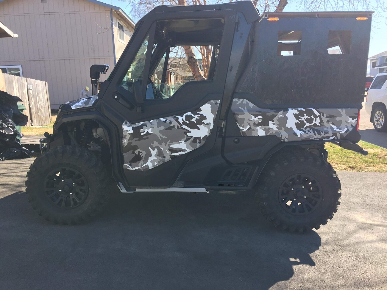

What’s the biggest tire I can run stock?
haha no, not asking that. What I am curious about is what are everyone’s thoughts on the below upgrade options I’m looking at.
My 2021 Pioneer 1000 has had a lot of upgrades already installed that add alot of weight. I want to go a different route for the wheel set. Because I installed alot bigger tires that are very grabby the dealership recommended only running in low gear to avoid clutch issues…..even in low at least two times I have felt the machine almost not be able to turn the tires when trying to get unstuck and this was not in thick mud, it was a gravel river bed and in snow.
The other reason is I would like to be change it up is I would like to run in high gear and really like the look of 10” wide tires all the way around. So thinking to just use the stock 14 rims go down a tire size to terrabites 28x10x14 all the way around. OR buy some 15” talon rims with terrabites 28x10x15….this option intrigues me because it allows the possibility of using small truck/suv tires.
what do you guys think?
Upgraded currently installed:
Full OEM hard cab with heat
Homemade rear canopy for my dogs.
Winch and front hitch set up
SuperATV a-arms front and back
814s 3 ways
29” maxxis 521s
Homemade snorkel
Dual battery setup
LED lights mounted to windshield

Nice ride, I like that camo pattern.
Them tires don't look that crazy where you'd have to run in low all the time. If you're in thick mud or real slushy snow etc. you should try to be in low but there's no reason not to be in high when you can.
As far as they stock wheels with 10" tires all around......you can do it but the side profile will be different between the fronts and rears due to the different wheel with/offsets.
If you want to run LTs then 15" rims will afford you way more options then 14s.
Most people do aftermarket wheels with a 5+2 offset and a 1" spacer on the rear to even the track a bit. This way you can rotate your tires if needed.....(stock wheels can not be rotated front to back)
Good luck

Height wise they measure around 31.5 if I recall when I first installed them. That may be why it had issues trying to turn them but even then I was never in thick mud or slushy snow.
