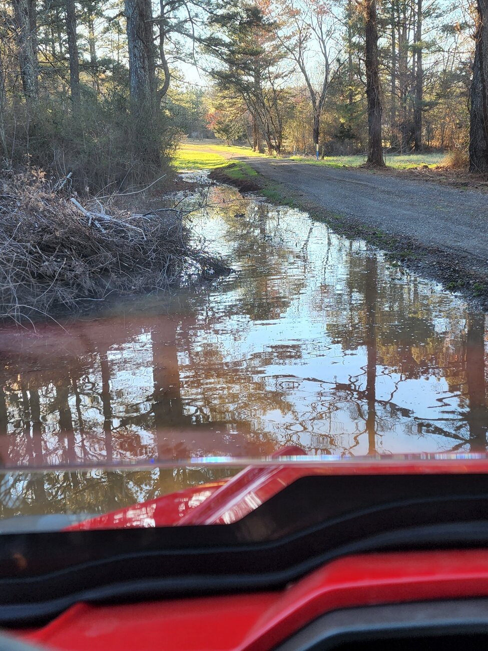

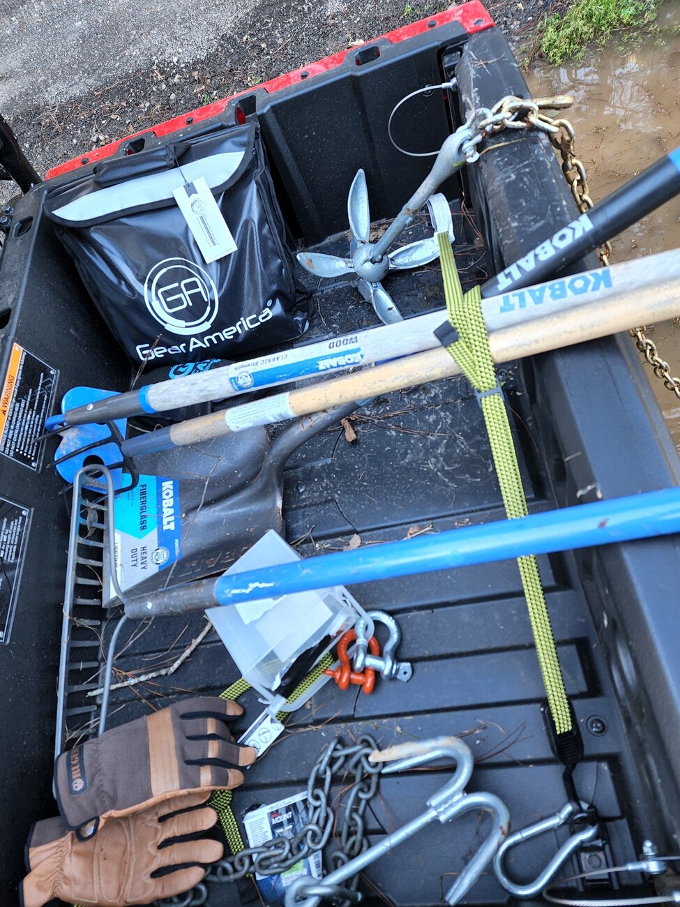

Day of med rain. At far end large drain pipe under road to lower ground. Pics of area and what i have been using to clear. Use for tree/log maneuvering to improve trail. My thoughts anyway. My Dad had a Ford 9N Tractor ,I remember seeing back wheels spinning at times using back blade. Front locker in my upgrade plan ,but not near future. Opinions on: 1. Am I asking to much for P520 1 1/4 system 2. pulling trigger now or wait for front locker. Download Dredger20220301 171951 resized 220220301 173206 resized 1

Day of med rain. At far end large drain pipe under road to lower ground. Pics of area and what i have been using to clear. Use for tree/log maneuvering to improve trail. My thoughts anyway. My Dad had a Ford 9N Tractor ,I remember seeing back wheels spinning at times using back blade. Front locker in my upgrade plan ,but not near future. Opinions on: 1. Am I asking to much for P520 1 1/4 system 2. pulling trigger now or wait for front locker.View attachment 325108View attachment 325109View attachment 325110
Opps ! my bad! Premature trigger pull...
