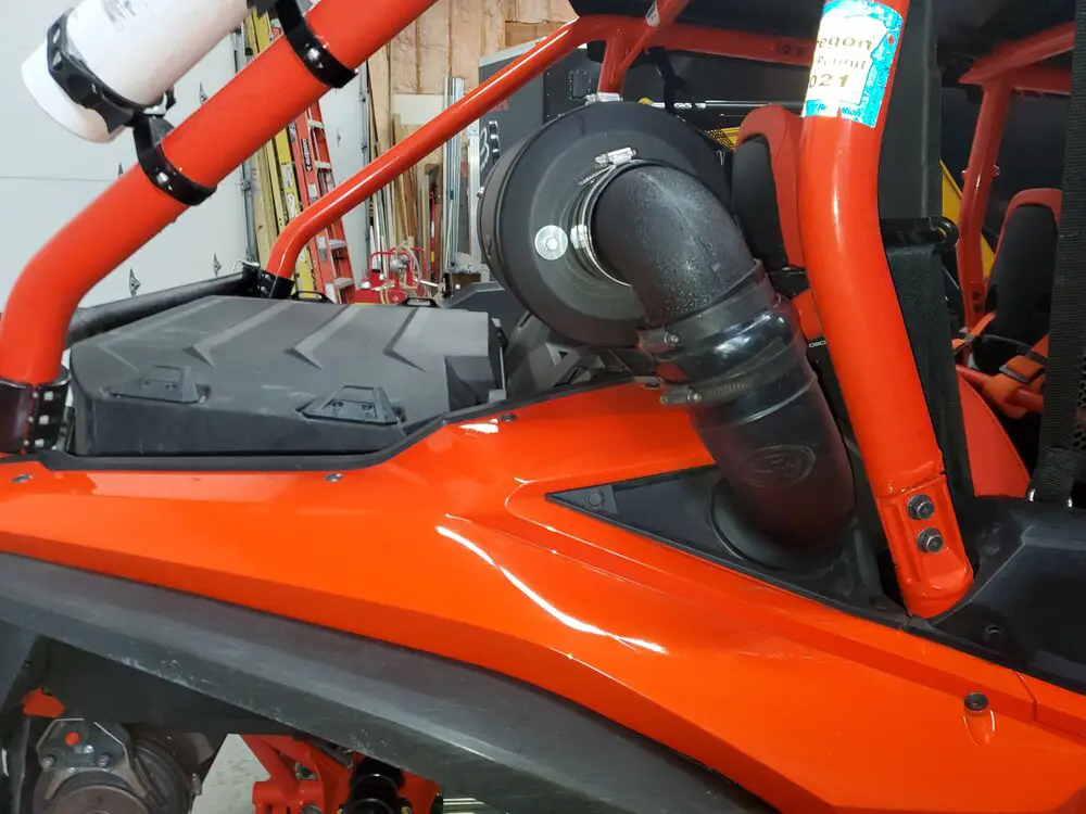

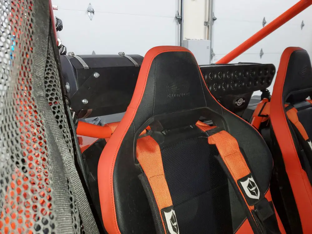

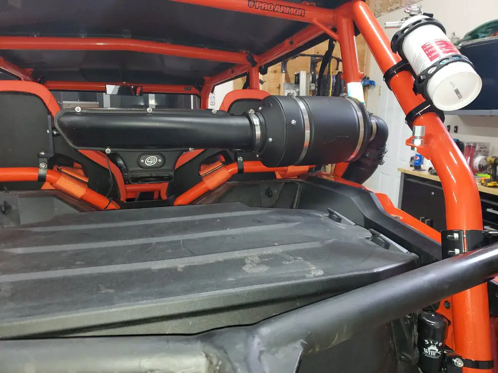

I did some modifications to my air intake / filter with the turbo kit. Honda says you can't use the particle separator with the turbo. See pictures and makes intake high in cab helps with the heat and has lowered filter cleanings and replacement by at least 50%. Access to filter super easy as well.
View attachment 240891 View attachment 240892 View attachment 240893
nice job. i just removed the jackson filter and installed a donaldson and built a snorkel for it
