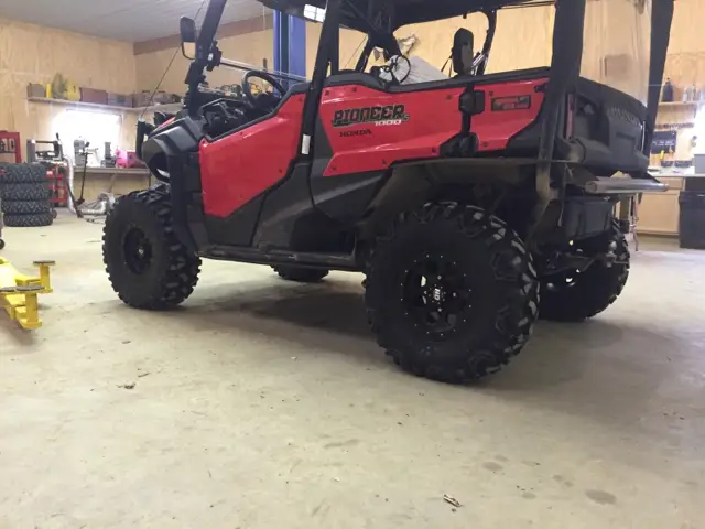

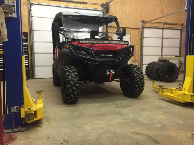

I am using an ITP 5-2 wheel. I'll share a pic or two below. I think the front width is 66" and the rear was roughly 2" more narrow. I added 1" wheel spacers to the rear to even it out. I'll have to measure the width again to be sure but that's close.

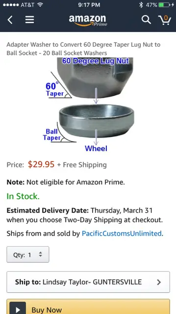

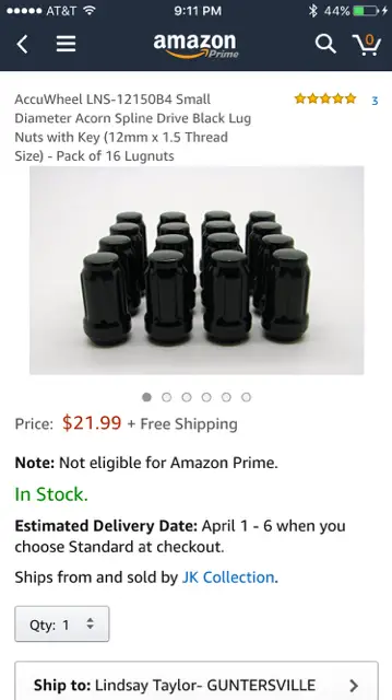

I bought teryx spacers and then bought adapters for the lug nuts.
I bought lug nuts like these at O'rielly's
7fc68a0c593347f4bf4c9a873602db8f
Then I bought adapter like these so I could use the same nuts for OEM wheels with a ball seat and ITP wheels with a taper seat.
924d76d45262fd36c252f0db46a27b12
