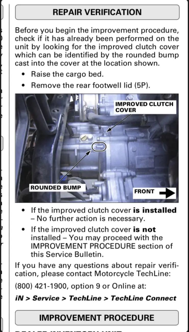

did it have the clutch update or did u did the full update when u did the clutches? Im sure with all the mods you have, many more questions will be asked

This one with the new cover or just the clutches?
