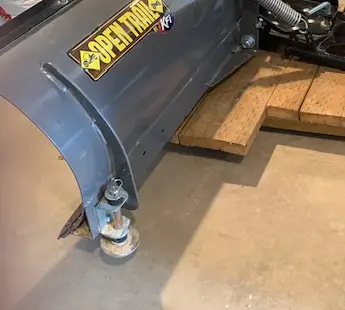

Yakman - my post about my KFI plow is above and the Denali has the same type of skid puck system.
Perfectly flat asphalt is easy, but you should still use the pucks to float your blade. The plow company's can't set the float height because everyone's machine has a different mounting point/blade angle, and your surface to be plowed may be smooth or rough.
Once your plow is mounted drive to a flat spot and lower the blade to the ground. The skid pucks on the sides have rubber bushings and stacks of washers above and below the puck.
1670125679894
You can either eyeball it or measure. Lift the blade, pull the top cotter pins, remove the pucks and then stack more washers above or below the bottom mount bracket. What you're initially looking for is that the pucks gently support the blade on the ground and there is a rubber bushing below the mounting bracket.
On smooth, flat asphalt, this is all you need. If you have ripples or a rough surface, you may want more washers below the mount to help the pucks float the blade without grinding the wear bar and ripping up asphalt.
This is something that takes some trial and error to see what works best for you.
I have a gravel road base driveway at my cabin. If everything's frozen, there's no problem. If things are soft and mushy, my pucks sink and the plow can peel up snow and a skeen of red rock road base that colors the snow. I pay for the road base and I'd rather not plow it off the driveway. I either move more washers below or feather the blade with the winch. Trial and error.
Best.
