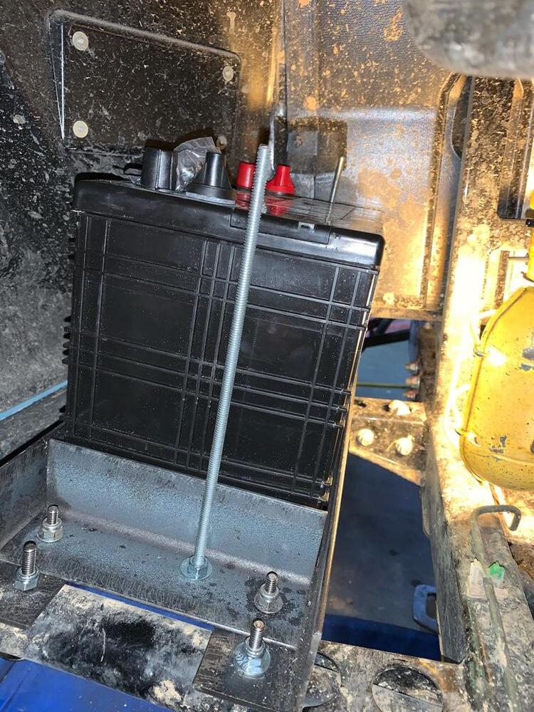

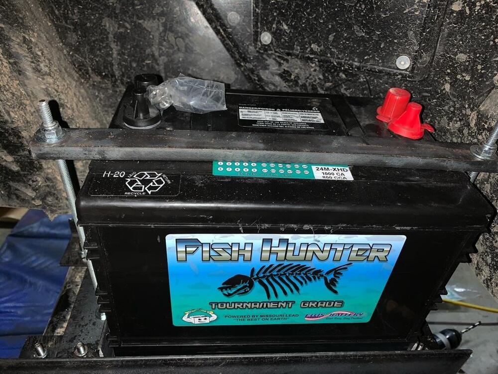

Dockman
Dockman
Jul 5, 2020
168
344
I have a 700-2 That I added a second battery system on. but I'm running a lot of lights and a front and rear winch's. According to the guy at my dealership there is no problem running a 50" light bar on the main battery!
I added the battery under the drivers seat had to build my own box for it I was only able to add a large garden tractor size battery and had to relocate the oil fill tube. start to finish it was about a 6 hour project but I'm a little OCD.
I added full size under drivers seat
397ff0e40792ea3aa8a98b6c67b2c5c0
9575f0e6b77451f92475bc81c3fe8413
Reactions: NewHere2
