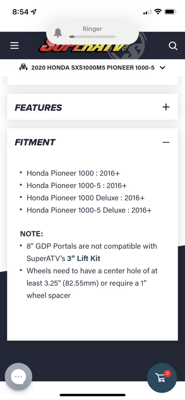

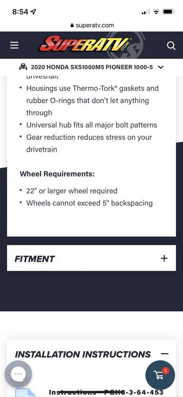

P1000 8” portals. What’s smallest rim size

It says 22” wheels minimum. But superatv visits this forum pretty regularly and will know the real answer
