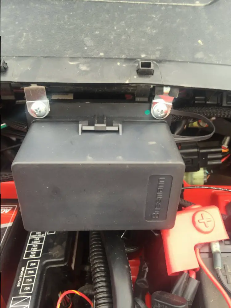

I used the same distribution box.
Mine is powered thru a solenoid that is activated by my Aux Power switch but you could activate it (or a relay) with key-on power.
For the LEDs I would use a fused line that is activated by a relay - triggered by headlight power in your case. Mine are on when the Aux power is on. I have it running from a second battery so I can run work lights, usb charger, or even the winch without starting the machine.
By using relays with any stock wiring (power on, headlight, reverse ground trigger) , you minimize the risk of your system interfering with anything. The LEDs on my switches are pulling about 80 mA. if you had 10 that would be 800 mA - not a lot but I like to isolate as much as possible. My relays are about 150 mA. Even if you only have a couple of LEDs I would still use a relay as an extra layer of isolation.

I crammed mine down there.
IMG 2413
