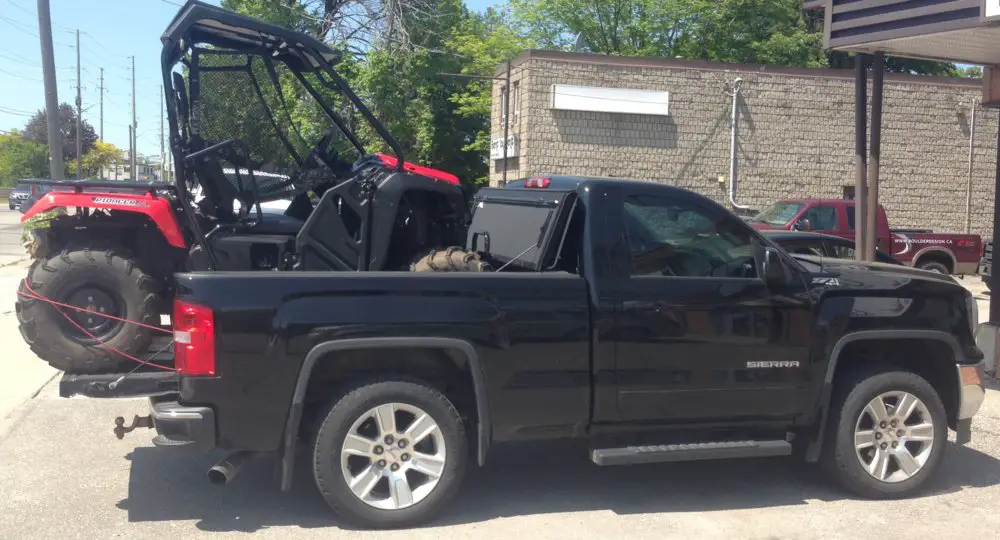

So a P500 fits in a shortie pick up truck. If the box cover was removed I would gain a few inches. The red rope is only there to hold the ramp on. There are 3 ratchet straps holding the sxs. Seems like the only way to get it over 40mph or 62kph!

That's a boat load of weight on two cables? o_O

I agree it’s a lot of weight on two cables. About the same as two 250 lb people on the tail gate assuming it’s equal weight on each of the 4 tires. It even looks a little big on the truck but it’s possible. I have a couple trailer options and that’s my preference.

Welcome to the Forum. Buy a trailer...

Welcome from Central Florida and please don't feel I am picking on you. This is just a pet peeve of mine. We hauled our ATVs in the back of our trucks for years with only a few minor problems. We, my sons and I, came to the conclusion it might not be the smartest or safest thing for us to be doing. We have gone to trailers.
One can argue all day long as to how they have never had a problem with hauling that way and that's great. I personally believe it's a unsafe practice, especially for the larger machines. I know one has to do what one must as its ones only way, but look at the size of that beast sitting in the back of that truck. Where does it go in the chance of a wreck? I know, we are all perfect drivers. Lol. It's the other idiots driving that scares the crap out of me. Maybe I am being paranoid but 25 years as a LEO and I saw some crazy things. What we must remember is being stupid does not preclude others from obtaining a driver's license. However you haul your toy, remember to do it as safely as you possibly can. Not only for yourself but others also. This is the short version of my rant on this subject and it is now over. I hope everyone has a great day.

Thanks everyone, like I said I have two trailers an 18 foot aluminum car hauler and a 16 foot aluminum enclosed trailer and I prefer to haul the P500 on a trailer. I tried it in the shortie box and it is possible so I took a pic. The pic was not to argue the best way to transport the P500, just that it was possible.

Glad you have the trailer option. The load on a bump and bounce can be a lot more than a static load. Comments are just all about helping others, maybe for new riders/owners bringing the machine home for the first time.

Thanks for the picture. It gave me the chance to post my rant. Most people strap it down to keep it from coming out the back of the truck and don't think of what it is going to do if they run into something at speed. Again please don't take what I said personal. It's just a old man who has learned from my and other peoples goof ups.

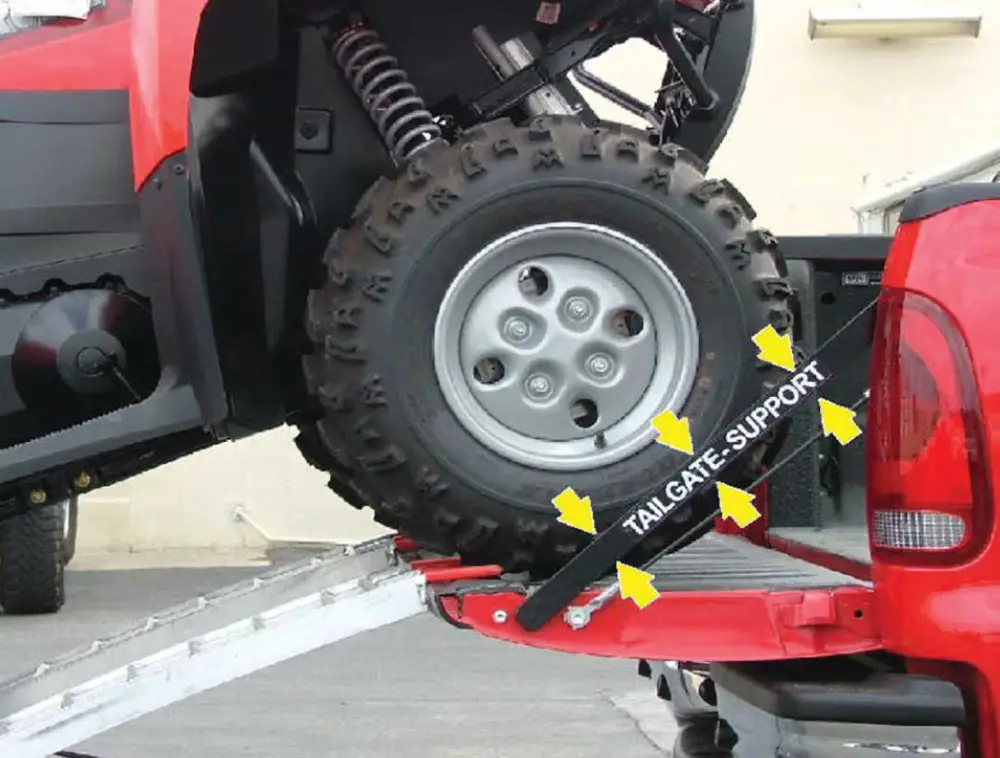

HAUL IT IN THE BED ! One of the many great things about a p5 . The DG gate supports are just in case the cables break and I have them to be on the safe side . I haven't heard of anyone having any negative issue from hauling one in their bed , nor have I heard of any tailgate straps breaking . IMHO it is SAFER to haul one in your bed then to tow a trailer . I have seen many trailers come off and cause serious wrecks and I have seen them cause wrecks without coming off . Never heard of a P5 being hauled in a bed causing any of these .

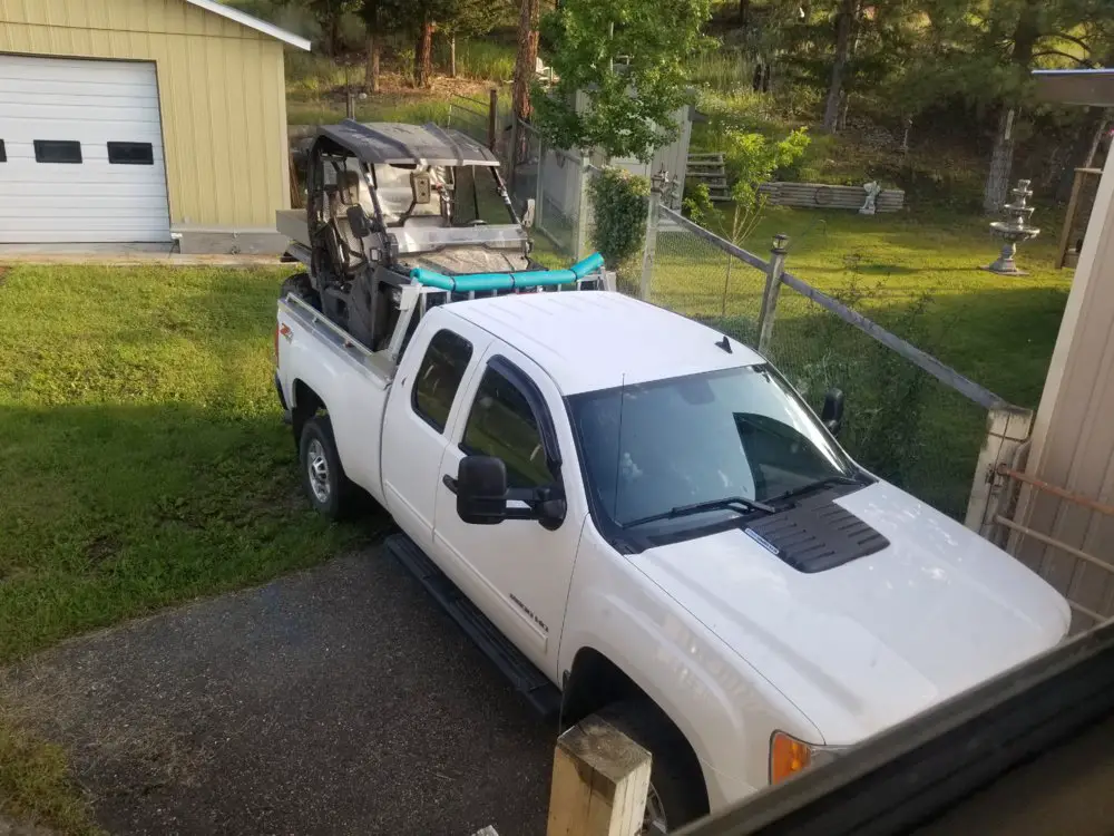

I take the 2” ball hitch out of P500 receiver and back mine in. You’ll gain a little more, weight forward and room too. Mine goes into 97 power stroke 7.3, with workbox fuel cell combo so 6” of room or so. Also lay down a piece of 3/4” pressure treated plywood with 1” angle iron bolted to the side of sheet to spread weight out so not as much strain on tailgate. 3 ratchet straps 1 over each rear tire and last one across the back. Works great quick easy to load, albeit can “feel scary” till you get the hang of it. Always.... always ratchet the loading ramps to the truck for loading and unloading. 80% of all ATV/UTV work place mishaps are loading-unloading.
Not a current image but you get the idea.
Cheers.
