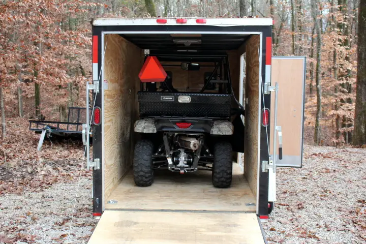

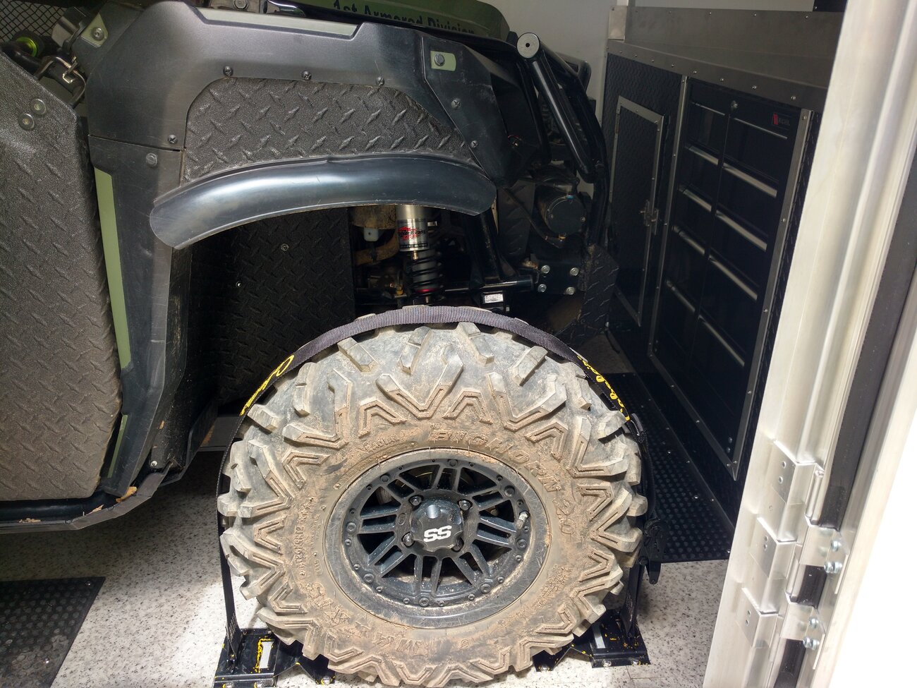

It'll fit but you'll probably have to crawl out the front or back. I think even hugging one side wouldn't be enough. This is a 7x12 loaded with a P5. I use the strap chocks to put it the same place every time.
View attachment 324411View attachment 324412
Thanks for the pics - good idea to put some traction strips. Is that fold down metal a custom piece to protect the opening edge?

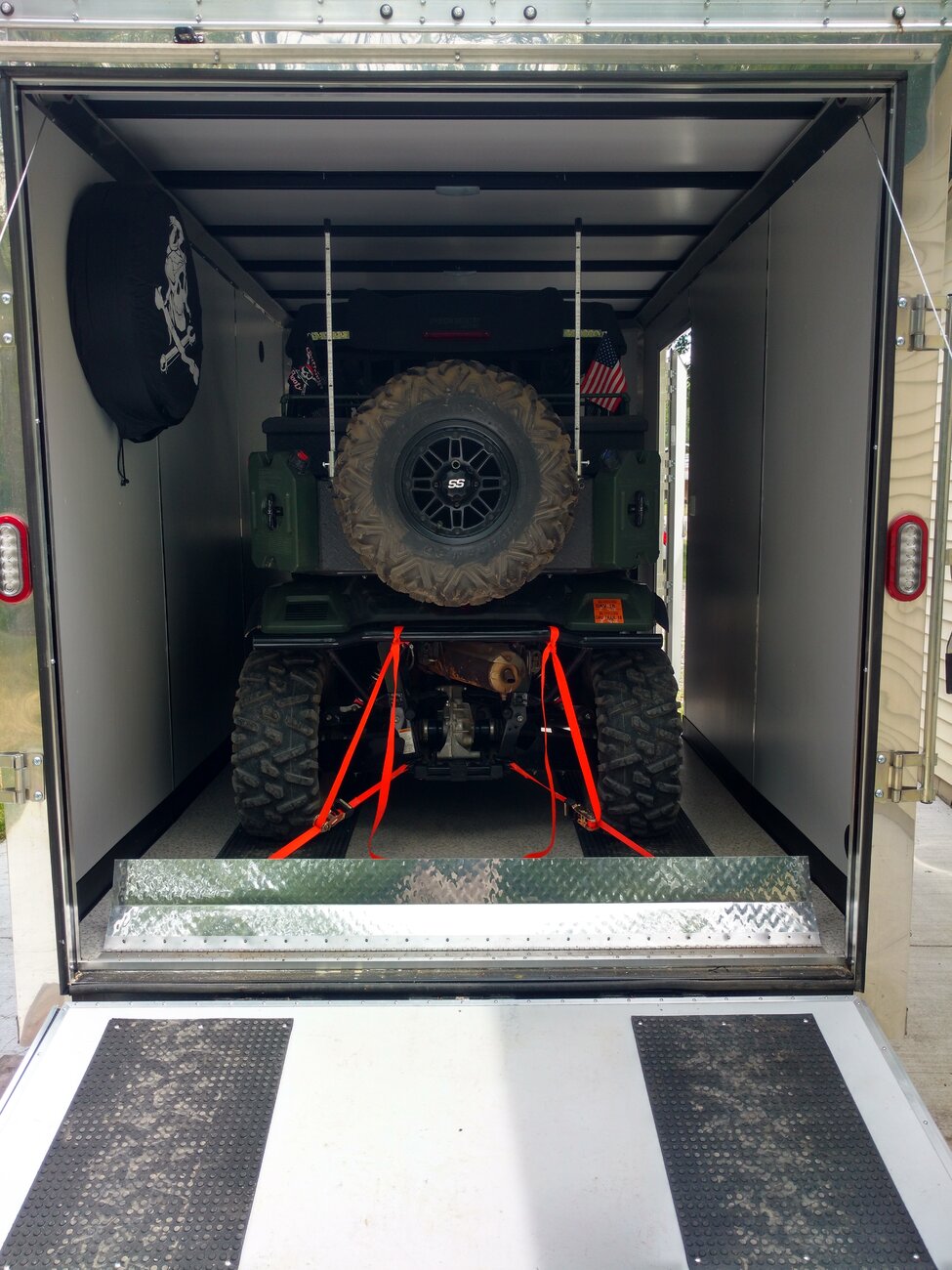

I have a single axle 6 x 12 Lark trailer with a 6” taller roof - Inside dimensions are 11'-4" L (13'-2" to V-nose) x 5'-8" W x 6'-6" H - Door opening is 63in W x 72-1/2in H.
My 2017 P-500 fits fine, open trailer side access door, fold in side mirrors, drive in forward, set brake, exit through passenger side and side access door of trailer..Tie down on 4 corners and your done.
To be sure this is a tight fit, but I had the trailer to move from Michigan to Alabama. If possible I would go bigger for your P-700.
415D233F 7A92 4CAF 87AC 15A20FD556813F929252 783E 448A 8C8E EB9BC0298B3D
No, I got that online to keep from tearing up the gap between the ramp and trailer floor. Also wrapped all the edges of the ramp in aluminum angle to protect those. Lots of stainless steel screws!
