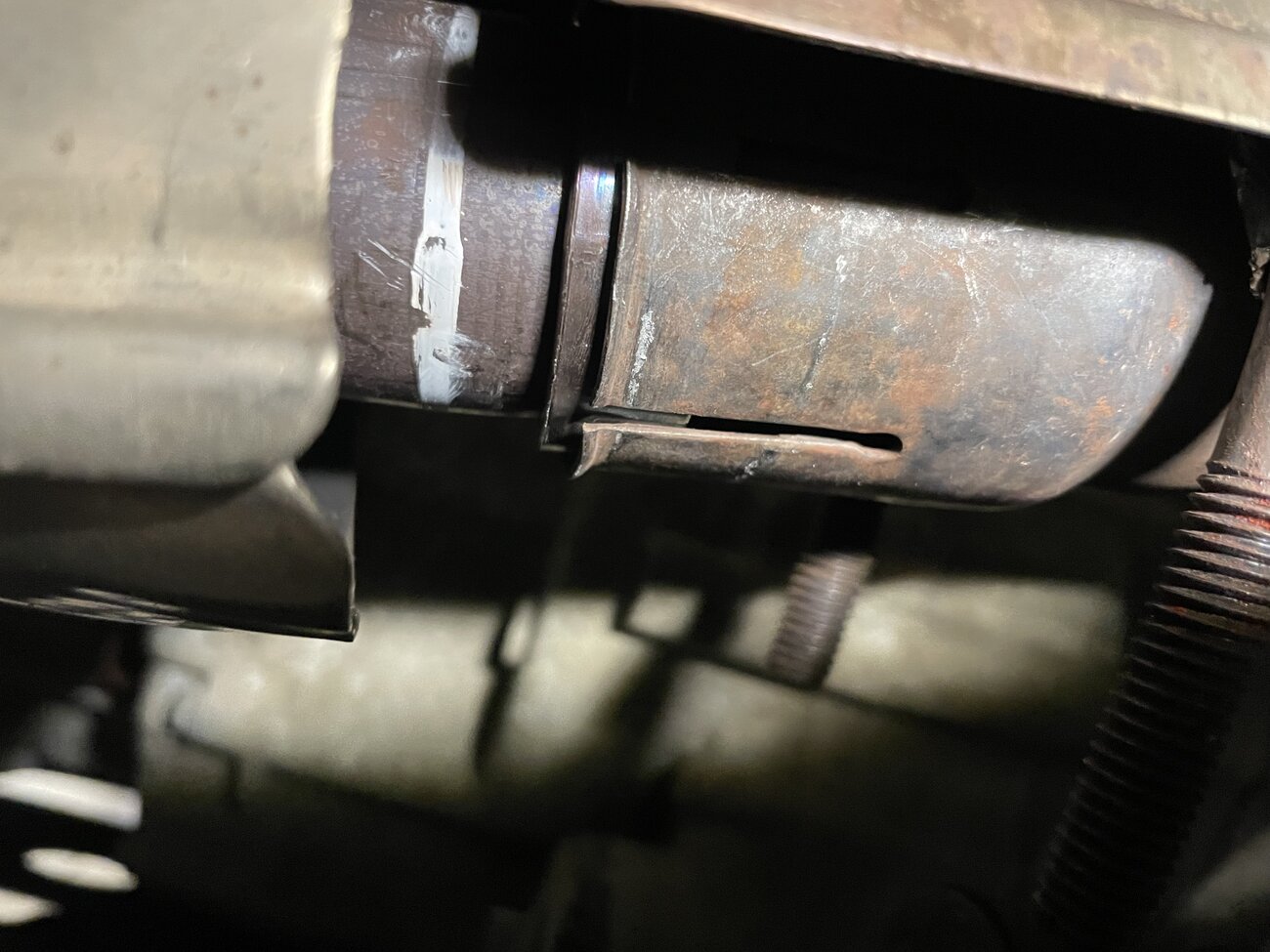

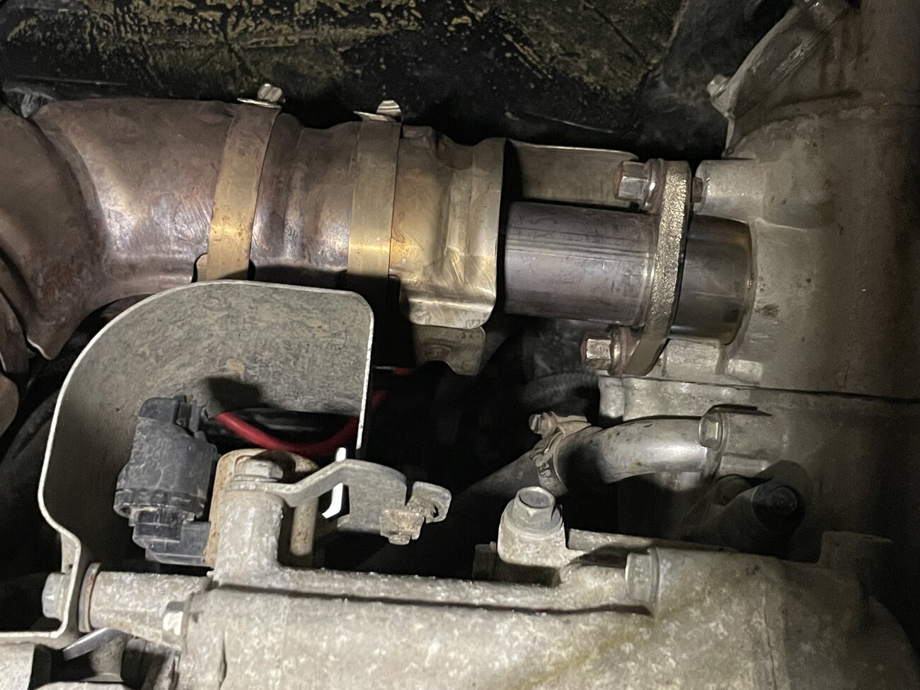

I’ve added a silent rider muffler, trying to quiet it down, but other than that the exhaust is stock. You can see here that the gasket on the header pipe is not going into the exhaust pipe as far as I would like. It would seem this problem would be less of an issue if the upper end of the header pipe went into the block a little bit more as you can see by the second picture. It’s like the whole header pipe is just pushed too far forward to get a good seal in the exhaust pipe.

Has it been this way since new?
20,185
115,430
couldn't get the exhaust joint to seal well, so I assumed the header pipe was warped, so I replaced it (and replaced the standard clamp with a 1 3/4" exhaust clamp while I was at it. However, it still doesn't seem like the header pipe goes far enough into the exhaust pipe to get a good seal.
I see u did replace it my bad.
Where did u get the pipe from?
Sounds like it may have not ben made correctly. Id take it back. Hard to really tell exactly whats going on.

Man I hope u got a good deal on the rig then when u bought it that way? That would have been a red flag to me. Sounds like after all you've done, there is alot more of something serious than just that pipe going on that u weren't told. At this point we cant tell without physical hands AND eyes on it. If u have a dealer or a local shop u can take it to? Even it it means driving a bit, might be your best shot at this point, cuz we are just throwing darts at it right now, cuz obviously it just looks like u need to find a way to get the manifold in there simple as that. But if it wont go then u have something more serious wrong! What? Dont know till physical hands can get in that rig. Maybe someone else will pipe in that can wave a wand and figure it out? As a mechanical tech (not a honda tech) I need my hands on it to go further.

hi - thanks for posting the pics, with remmy on this, very hard to tell......
im guessing here, take it all off, put it on the bench, get that joint coupled correctly then try to fit it back on
-advice is to get rid of that silent rider, most comments are a little bit quieter but they cause back pressure - heat back into the machine and makes the heat worse
-it could be a bent hanger somewhere
-those slotted slip joints are tricky, fixed a bunch of them on multiple machines over time - they are finicky to get flared, get the gasket in and get the pipe pushed in - lots of times I had to just put on the bench and get it flared just right
-if worse comes to worse - just put some exhaust wrap around that joint and move on

Just a question here. Are those header bolts bottomed out? Are they the right ones?

The gasket I'm referring to is Part # 18392-MBH-000 its item 13 on the partzilla diagram. The back half of the exhaust is hung with rubber, check that nothing got whacked by the previous owner, see if you can shift it forward. I recall that I had to loosen and shift a lot of things to get the new gasket in.
