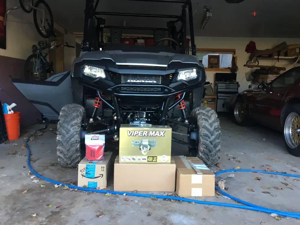

Got some presents from the FedEx guy today! Uni air filter, viper winch and mount, and my motoalliance plow mount!
View attachment 26168 Got some presents from the FedEx guy today! Uni air filter, viper winch and mount, and my motoalliance plow mount!
Very cool. We're keeping them and UPS in business. What's that good looking ride on the right??

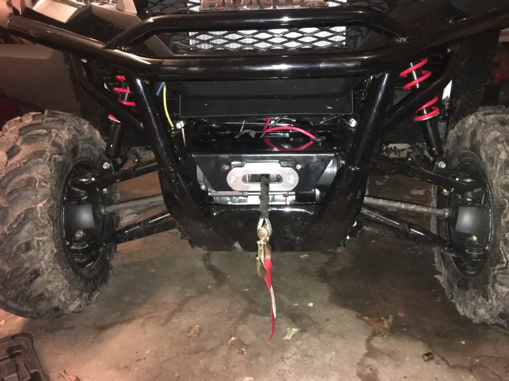

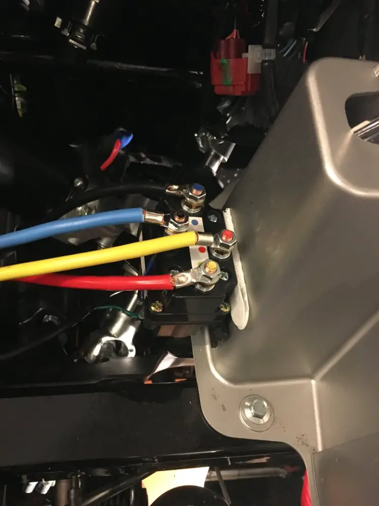

Got the winch on tonight. I just wired the red (key on) wire directly to the battery for the moment, made sure it worked. I think I'm going to splice it into the 12v accessorie plug to finish it up. Is that the white wire? I also used someone's truck to swap out the red/black wires and there blue/yellow wires due to length. Works just fin
Reactions: Tigermark
View attachment 26573 View attachment 26572 Got the winch on tonight. I just wired the red (key on) wire directly to the battery for the moment, made sure it worked. I think I'm going to splice it into the 12v accessorie plug to finish it up. Is that the white wire? I also used someone's truck to swap out the red/black wires and there blue/yellow wires due to length. Works just fin
Looks good and clean. Just need heat shrink on those connectors.
Yup, didn't have any laying around so I'll have to grab some. One thing I've noticed on the pioneer compared to my commander is these are way easier to wire things and even install stuff inside the frame such as a winch. A lot of open space.
