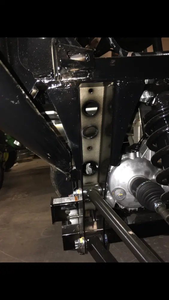

My 2021 that I picked up in March had missing paint on the right rear.
...not just light paint, completely missing paint....bare steel.
pics comparing right side and left side

Well, that sucks! If you paint it unfortunately not as good as factory powder coat. Hope it’s a bolted on part that the dealer can order a powered coated part from the factory.

No unbolting. It is the rear frame.
Same machine as in your profile pic. Compare the pictures I attached to the rear of your machine. Look at the rear of each side behind the rear tires.
I don’t see how it could be powder coat. Sure looks like it was sprayed from a gun. Driver’s side has so much paint in that area that there are runs in the paint. Given powder coat is a dry film and then baked, I don’t think runs are possible but could be wrong.
Passenger side no paint.

Prob some electro plate type paint. Seems pretty tough.
Yeah looked at my frame last night, all's painted. Unfortunately the dealer will prob end out doing just what you're going to do, rattle can paint. Also I had the same issue with the fuse box under the front hood. Played with it a bit and got the cover to hold. Cheaply done for sure!
