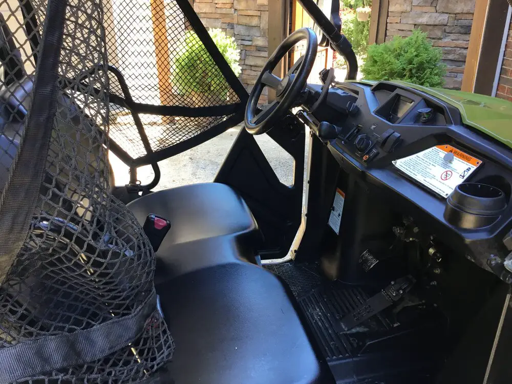

P500 Find the 12 mods in this picture?
Mudder
Mudder
NTC Ambassador of Walls
Oct 1, 2016
11,691
88,486
What can you do with the P500? Things within this cab area RELATE to 12+ mods. Take a guess. Hint: two cost $0 based on shared forum ideas. I’ll fill in the list with correct replies.
For those that know Mudders ride, the 12 does not include the unseen cab mods like the MTX overhead audio pod, roof, rear panel or ROPS mounted Tyt 8600 radio.
Thread just to show how many ideas for the P500 are possible. Maybe help some new owners.
1.winch in/out switch mounted seen behind steering wheel at base of ROPS
2. Throttle max Gas pedal
3. Dash switches for a cargo bed light and a horn
4. box
5. Koplin swinging Mirrors
6. Voltmeter/USB beside the upper dash display
7. Seat belt interlock over ride disable (removed small piece) $0 cost thanks to Forum
8. Reverse level adjustment, no more pulling $0 cost thanks to Forum
9. Trigger shield heat/noise barrier under the seat
10. Power steering
11. TORQMASTER front diff locker
12. Ctek battery charger plug
Good eyes, you identified some I left off. A lot going on in the cab area. LOL
Added 13. Trash can storage under seat, $3 cost thanks to Forum
Added 14. Mudbuster fender flares (push pins visible)
Added 15. Bolts showing for aluminum wheel well protectors (at foot level warning label).

What can you do with the P500? Things within this cab area RELATE to 12 mods. Take a guess. Hint: two cost $0 based on shared forum ideas. I’ll fill in the list with correct replies.
1. Throttle Max
2. Mirrors
3. Winch switch by minus paddle
4. USB by the display
5. Rocker switch 1 light bar
6. Rocker switch 2 backup light
7. box with the factory label
8. Switch/voltmeter below the rocker switches
9. Switch on the label down at the footwell
10. Seatbelt override
11. 2nd battery
12. Under seat storage
13. Some sort of 4wd shifter hole cover
My best guesses, nice ride!

Adjusted the reverse cable so you don't have to use the lever.
Hondasxs.com seat belt interlock delete.
You have inner fenders to stop sticks coming threw the lower dash panel?
There is a clip in the middle of the warning label by the drivers knee.
Edit: Is the for the mud busters mentioned above?
Warning label dots at bolt heads wheel well are for metal plate protectors. No clip.
2 of those remaining were $$, one of which was spurred by Forum members.
One other was thanks to a Forum Member (a popular addition)
Lower left dash item and second dash rocker switch still up for grabs.

Yes, gotta have a @trigger shield. Only yellows left. Hint: A sunny day and I’m charged up to steer straight through some awesome mud holes.
4. box
10. Power steering
11. Torqmaster front diff locker
12. C tek battery charger plug

One correct. Power steering.

That middle lever pulls a cable that moves a fork,that engages a diff,that has a "LOCKER" ???????

All done, last item on dash is a battery charger plug with LED battery status.
