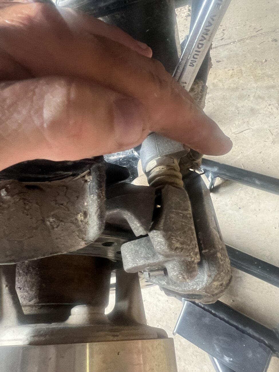

I busted up my driveway recently and hauled it to a friends and on the first trip I had the trailer slightly(way too heavy) overloaded. He said he almost died going down a steep hill. We’re guessing it broke during that trip, he was standing on the brakes pretty hard.

I am not sure how much weight is there but Honda advertises 2000lb trailer load. I am surprised it broke.

30% more would most likely put it over. You also must include the weight of the trailer in that 2000#. Finally, your hitch weight is most likely going to be WAY over if the rocks cover the entire trailer. You can't have 600# on the hitch!
While not as critical as a car @ highway speed, I wouldn't load more than 20%, give or take, on the hitch, if pulling a trailer like this with my P1K5.
If you want to pull 2000# less the trailer weight, load it towards the rear and let the trailer do the heavy lifting.
P.S. - Don't take my word for this. Ask @Backwoods. He knows everything ... 😆

It was fine to pull on normal ground but we went down a real steep hill to get it to the location to dump it. I’m not sure that’s what broke it is just a guess. Has anyone else seen this part brake?
