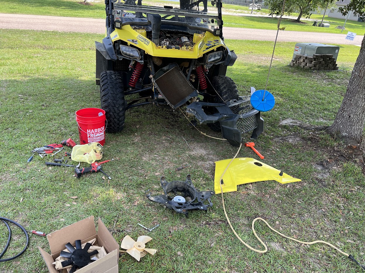

Ok, so I'm stuck. I know this isnt the thread for this, but I dont know which one is and a lot of people see this one frequently. P1K Had to replace both upper ball joints. They are all good. On one side, I had to remove the lower ball joint also so I could replace the bearing. Bearing pressed in fine. But, I can't get the lower ball joint to seat far enough in to get the snap ring seated properly in the groove. I even scraped away the powder coat on the back side so the lip of the ball joint would sit flush and as far in as possible. I thought I remember hearing that the P1K has common parts to a Honda car (Civic?) Is there any Honda automotive lower ball joint that is the same as the P1K? Mine is getting beat up from me taking it in and out and a new one might solve my issue. Any advice is appreciated.

I got no knowledge to help ya lol. Worse case scenario, I have new ball joints here in Tennessee. if you can't get it right before you get here.
Thanks TripleB. That's what I'm starting to think is to try to find one along the way and install once I get down to TO. Gonna fight it a bit more, but soon it's time to move on. Plan to leave at o'dark thirty on Tuesday.
