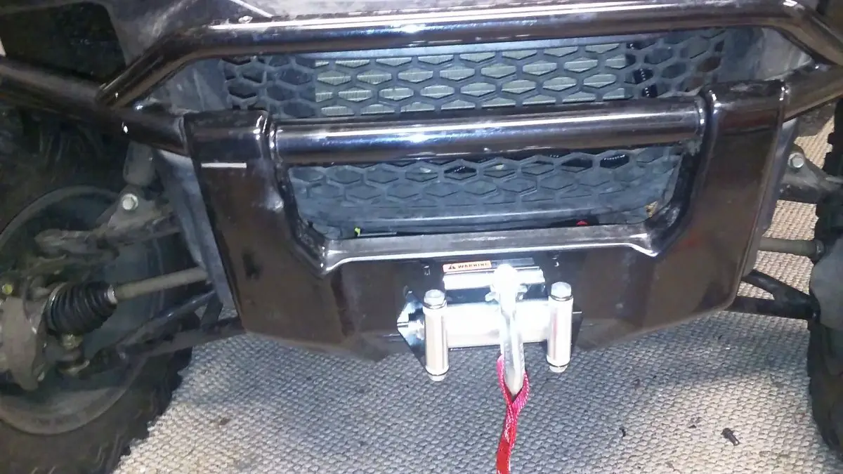

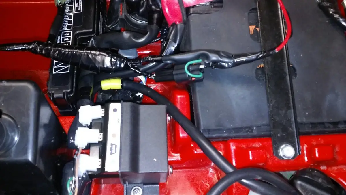

After getting the kit. I downloaded the instructions and page 10 was not in the instructions. This page shows how to tie into the fan plug. After spending time on the phone with warn they found the page that shows the wire harness, and how it plugs inline to the fan. The 2 plugs on the winch wire harness did not match the plugs on the fan. The tech at warn told me plug the male and female that would normally go inline with the fan and plug them into each other, then tap into the white wire with a silver stripe. the green wire is a ground. I wired into the white wire and ran it to the accessory fuse on the fuse box so the winch controller gets power when the key is on.
The instructions has you pulling the front end plastic and dash NOT lol all the wires are color coded blue and yellow go to blue and yellow on the winch. black to ground red goes to the starter solenoid next to the battery.
the 3 small wires go to the same color code on the controller. Here are pics of what I did.
View attachment 8694 View attachment 8695 View attachment 8696 View attachment 8697
The 12v accessory socket that is in the dash is where you plug in to get control power to the 2-pin connectors on the winch remote receptacle harness. you plug one of them into the back of the accessory socket, and then you plug the other one into the plug that you removed from the accessory socket. In other words, they don't go inline with the fan, they go inline with the 12v accessory socket, supposedly (I have not confirmed this).
I currently have mine the same way you do, as my winch kit from Honda came with NO instructions and I had to figure it all out on my own. I have since gotten the instructions and it shows what I described above. I plan to redo mine as soon as I get over this pinched nerve!:mad:

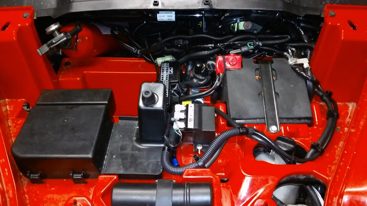

the sub harness connects to the back of the accessory you can reach it without taking the whole thing apart just do it by feel
H
HondaTech
P700 ties into fan, P1000 is accessory plug. I always give a copy of the instructions to the customer because Honda's website is unreliable as hell.
