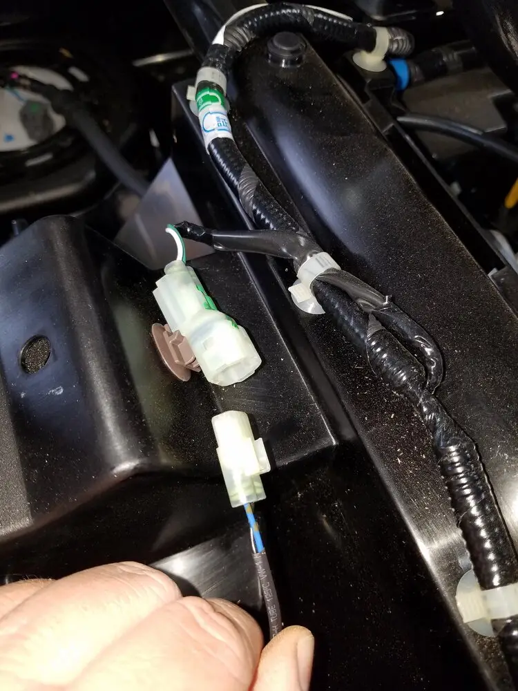

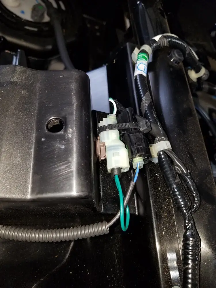

Pull the seat off, then pull the plastic panels off. IIRC, there is a driver side panel, a passenger side, and a center panel over the seam towards the back of the seat. Under there, connected to the seat belt latch, is a plug with 2 prongs. make sure that is plugged in. Its also a great time to bypass it with an override sold at the club store.
