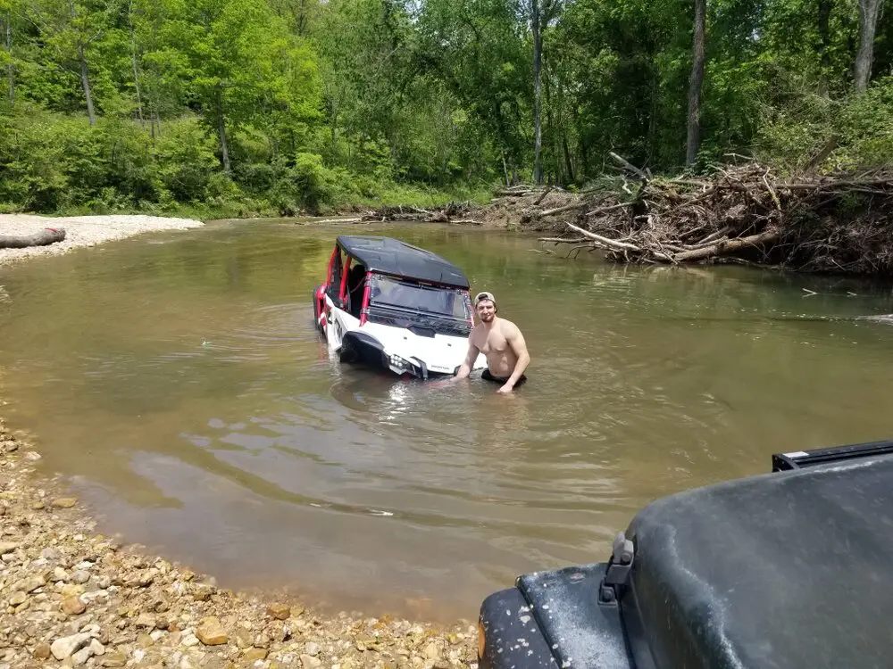

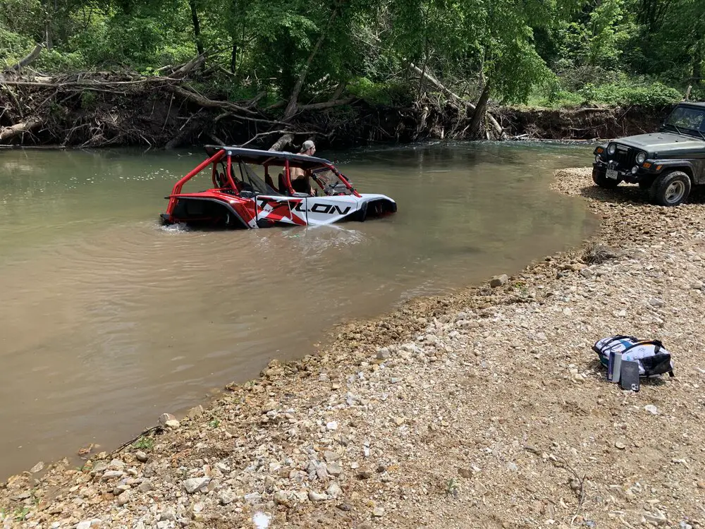

So took the Talon out to the creek today and was driving through the water. Didn't have seat belt on and wasn't a problem, but hit some soft spot in the sand. Due to the seat belt being off the talon hit the rev limiter, (15mph) while spinning out. Nevertheless I got stuck. Water was up to dash and got out with it still running to hook up winch, after few minutes machine shut off, uh oh. Also water never did get up above the intake, it was leaning. Ended up trying to start it back but would not start back up under water. Got it back out onto dry land and still wouldn't start. Luckily I wasn't too far from home and was pulled back to my house.
I let it sit for about 2 hours and tried starting, still won't start. I removed all 4 seats and blew out water around electrical connections. I removed spark plugs and cranked for a while and found that had some moisture on plugs. Checked the oil and oil is milky, uh oh #2. Haven't checked the sub trans or trans oil yet.
So my question is, if I flush the trans, sub trans, front and rear differentials, and oil, take to dealer will my warranty be voided? I'm sure I can get it started as long as the electrical modules aren't fried, but if I can't would my warranty be pointless if there's more damage to the motor?
From what I've read I'm assuming their are vents to fuel tank and some other components. Is their another decent way to direct those to keep this from happening again. I probably would have been fine had the talon not died while sitting in water. It probably set in water for 15 mins while we got it out.
Try to keep the hate to a minimum, I realize that these aren't submarines, but a little beer and these things sure seem like they can go anywhere lol.
I attached some photos...maybe a learning experience for someone else, or a nice chuckle?

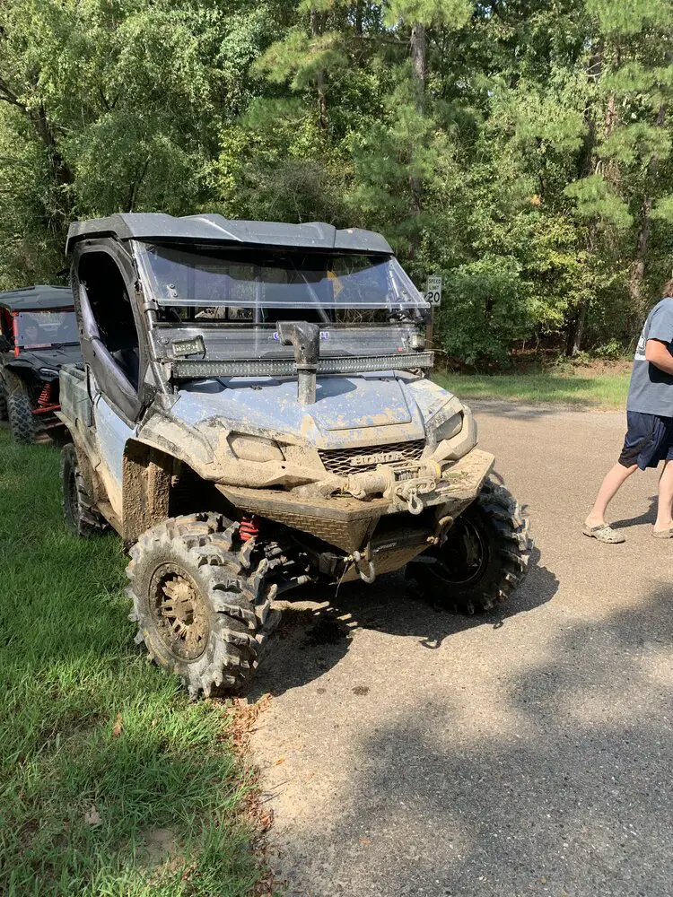

What kind of bumper is that? I like it.
