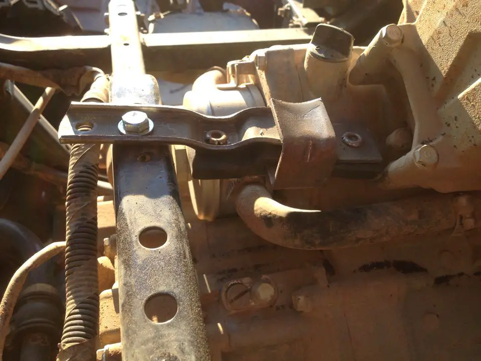

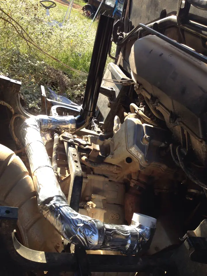

this is what you see from rear of engine looking forward. the factory air duct has a rubber 90 at engine to loosen on pipe side with #2 pillips and a rubber coupler under front seat near bottom frame same style clamp, then 2 pull tabs one at front i have pulled see the holes and one at rear near engine is tricky to see but maybe thats just cause my buggy is filthy, anyhow take the front rubber coupler off both pipes and you can drop pipe down and towards drivers side and pull up and out through seat hole real easy
Looking forward from back of engine Front tab on air duct Rear tab on air duct Air duct and coupler Air pipe coming out

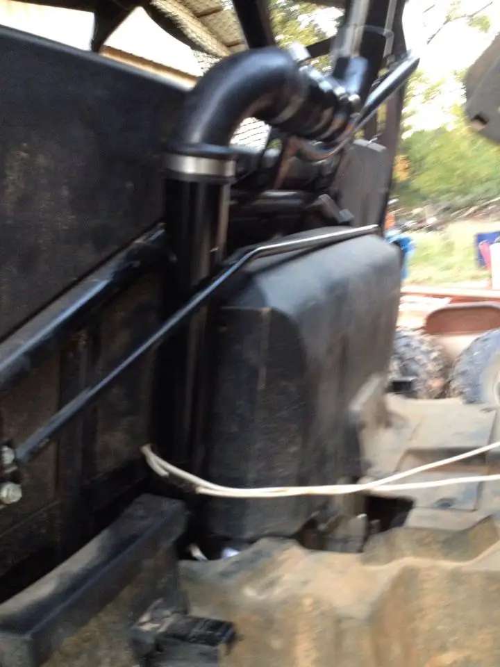

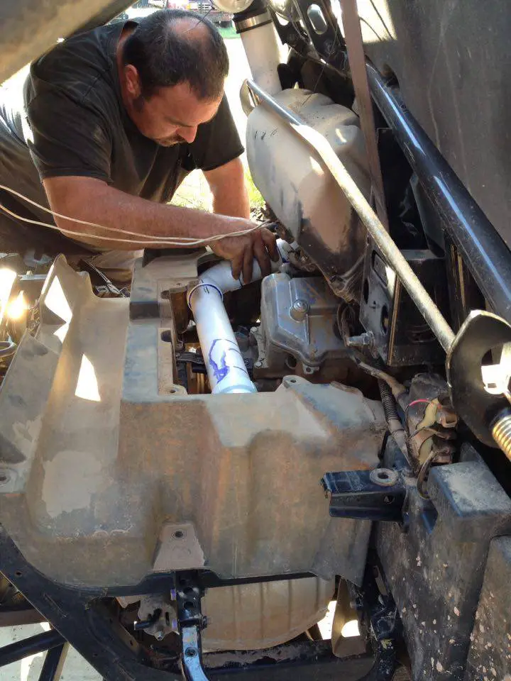

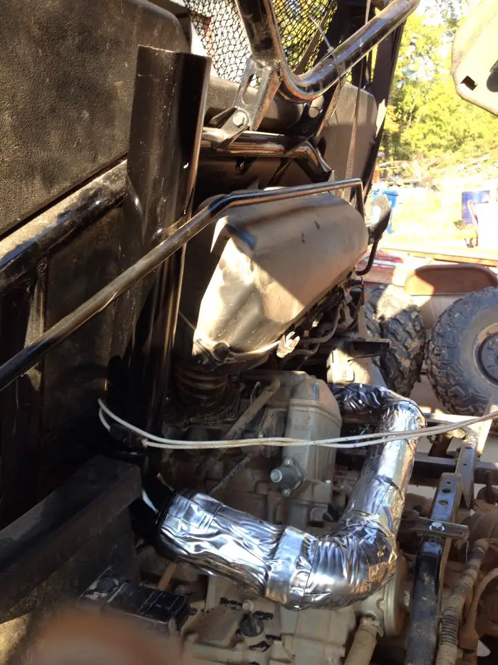

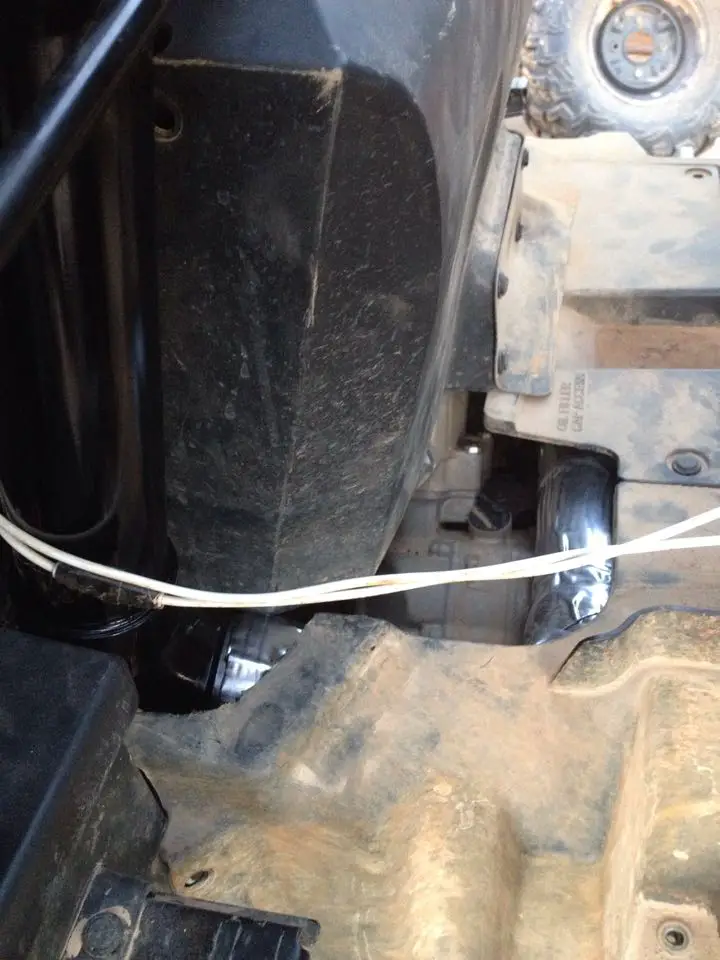

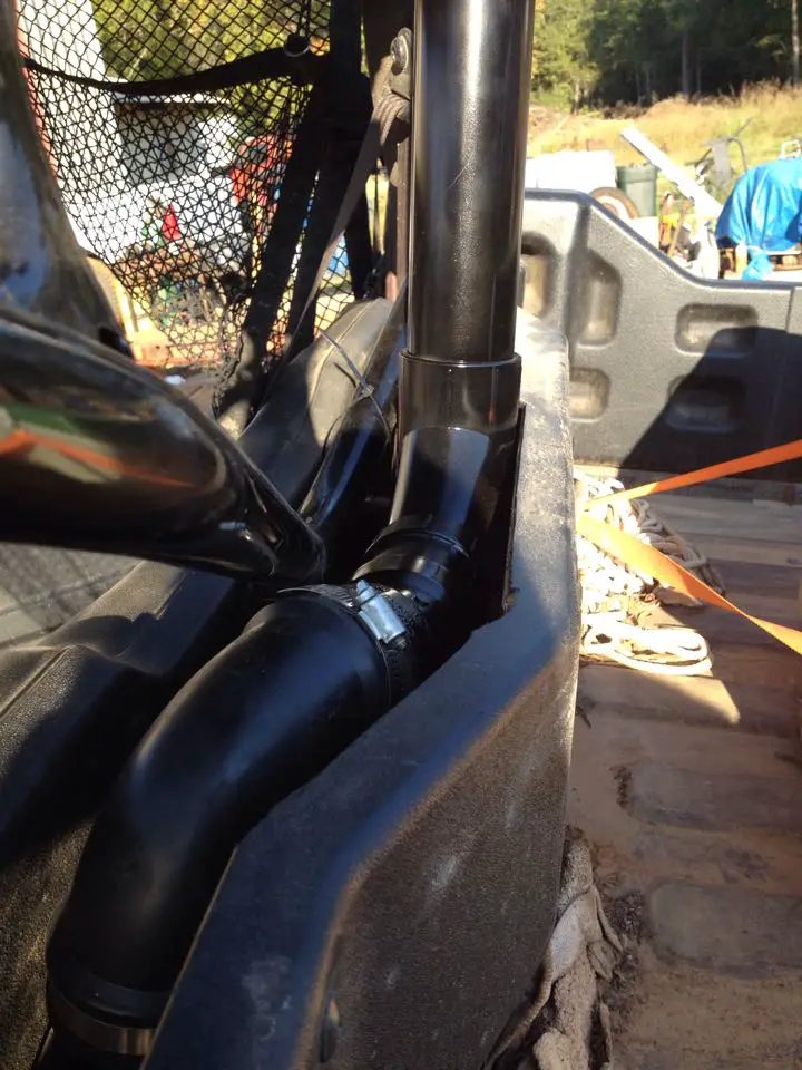

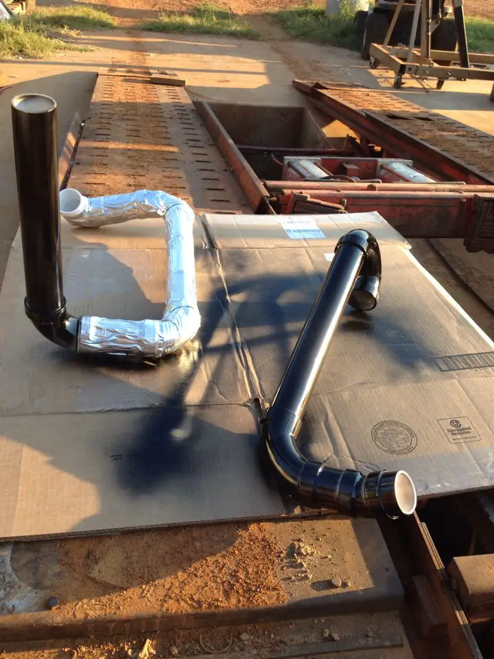

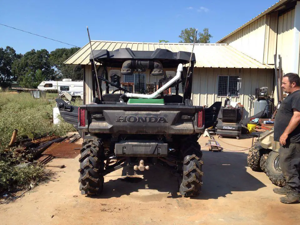

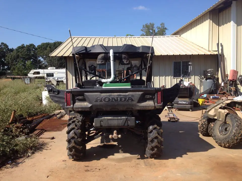

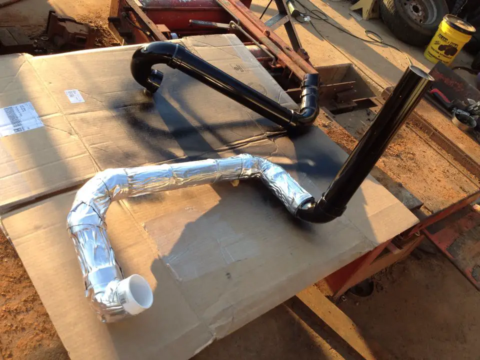

next ,pipes and pipe couplings were flying all over this thing like a mad man trying to break a code on a bank vault , but through the miracle of time I found a good combo of parts and measurements , added a little exhaust bracket to help support the new crossover pipe, then I had to do some minor cutting to the engine cover plastic on drivers side , I also had to trim the front top plastic that hangs over the square metal frame on the bed for pipe to not interfere with dump operations , missed that photo op somehow. then i looked at it going to the right side behind seat but i chose to put it in the middle to keep mud away from intake. decided to wrap the pieces around the engine with some aluminum sealer wrap stuff I had laying around from some auction box lot , should keep most heat off the pipe. will look better painted so that was next. then I need to build a few more brackets to hold upper pipe to rops.
Air pipe bracket Engine cover over snorkel Snorkel to right side Snrokel up Snorkel paint Snorkel paint 2 Snorkel rap
