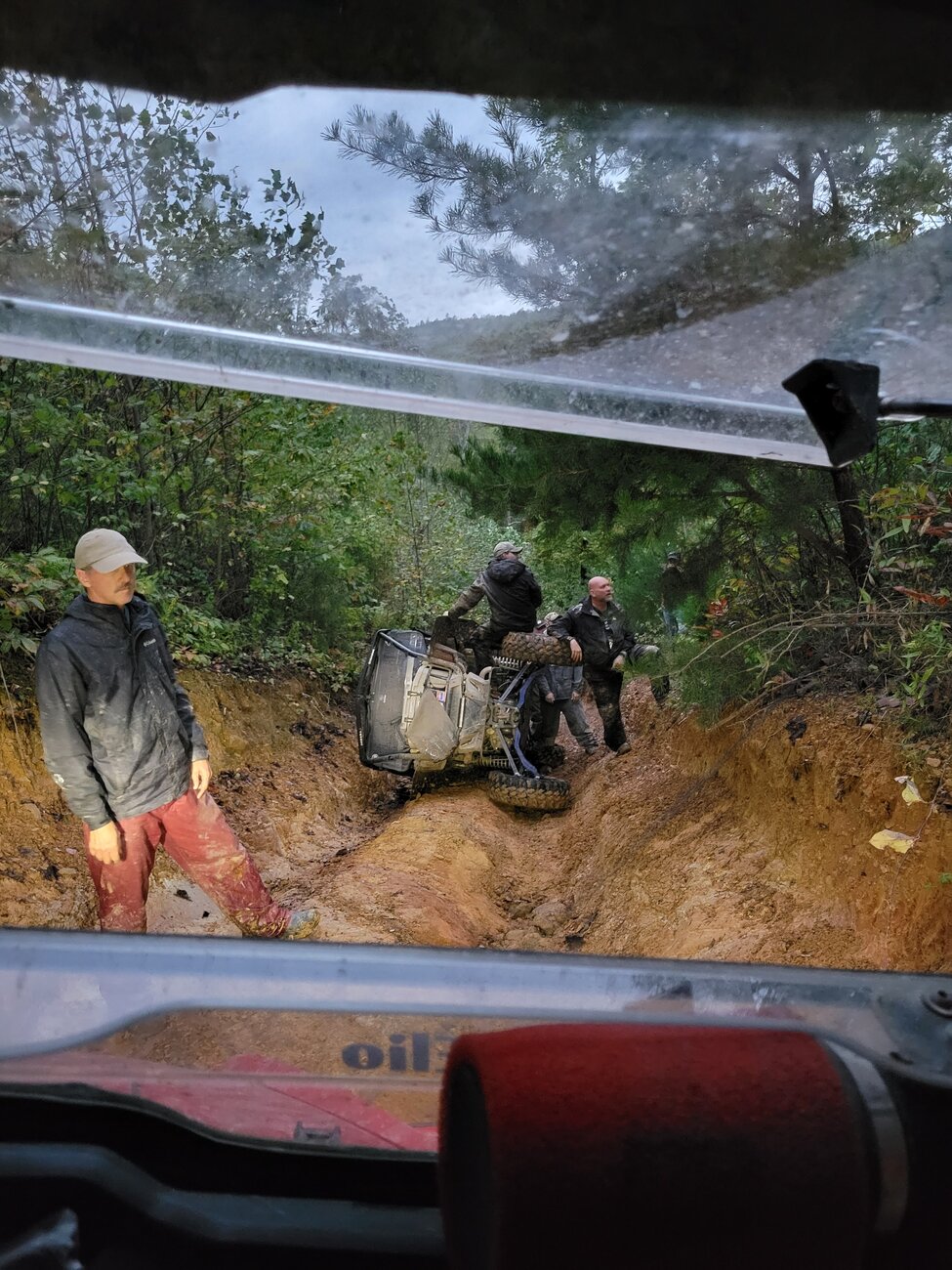

In the picture I posted above, and pretty much all the SXS naps I've witnessed and been part of......you shut the engine off, after some expert wenching you're back on all 4 wheels and the machines always start right back up. I've never been napping on my top skid plate (🤞not to either) so I can't speak to that scenario 🤷‍♂️
