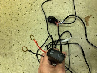

Just bought a set of low cost pods. They have a good harness but have a luminated toggle switch. If i hook it up to the battery the toggle is always on. What are my options on my 2015 700-4?

use this or equivalent, there is one on this site in the store or go to EBAY
KEY ON POWER Harness for Honda Pioneer 1000, 700, 500, and Talon 1000.
