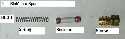

Is this the piece that fell out?
If so, remove the plug and this little guy threads on the end, make sure it's tight!
The plug wire literally snaps onto this little piece. Try snapping it in with the plug still removed so you Have a feel for how it should be. Then reinstall the plug and snap the wire on and hopefully that's all there is to it! I hope that answers your question.

thanks for the reply, but no there is a spring and something that looks like a round fuse (not the automotive glass type ). inside the boot there is a stud, a spring, the fuse thing and it all is held in by the female part that goes onto the piece you have pictured. the female part is threaded and holds all of the other pieces inside the rubber boot. could you maybe use locktite on the threads?

It is a RFI "Radio Frequency Interrupter", all of my old XR bikes had them. Stretch the spring out a little before reinstalling it next time, it will let it keep a little more pressure on the retaining nut and possibly keep it from loosening up. Another good thing to have on you is a piece of aluminum foil to wrap it in in the event that it fails; no go if it fails. It may however cause failure of other ignition or electrical parts if ran in that manner for long periods, although I never personally experienced any adverse effects. I had an 86 XR250R than ran that way for many years.

After reassembling everything in the spark plug boot and putting things back my engine seems to run much smoother now. I'm thinking the "screw" as referenced in the picture in post #10 had backed out to the point where the connection/current to the plug was compromised. Because this happened so slowly, it was hard to notice symptoms until they got pretty bad. But once fixed it really made a difference. Now the engine runs as it should.
