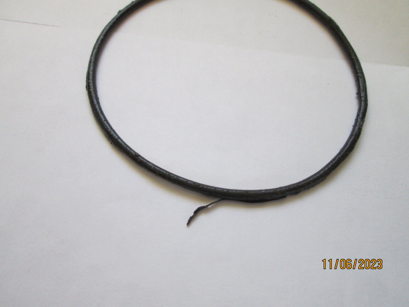

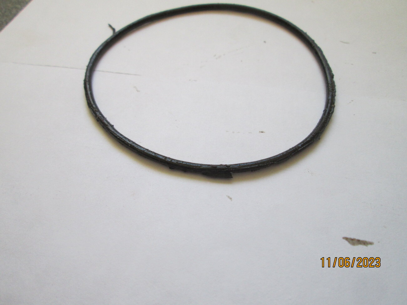

So i found when I looked in through the bottom access hole I could see the O ring for the filter cap . So was able to turn it 2 more turns . Filled up the oil and was good. Started motor oil running out from somewhere. Think its the oil ring but cant be sure as its very hard to see in there.. Pulled off the oil filter cap and maybe the oil ring got chewed up. Going to start with a new o Ring.
View attachment 408792 View attachment 408793
Yea. You have to make sure it doesn't get pinched when you put it on. Make sure you oil the o ring up good before you put it in

So Big Red back at farm work.
$8.11 for the new O ring. Was not sure if that was the problem Fingers crosses it was.
Have to see if I start burning oil now . But it was only a minute until I stopped when I was out of oil.
Everyone here knows what a pain in the butt it is to change that oil filter. Today I was able to get one hand in the small hole and a second arm hand from the left side over motor and down to push on the filter and hold the bolt in position.
