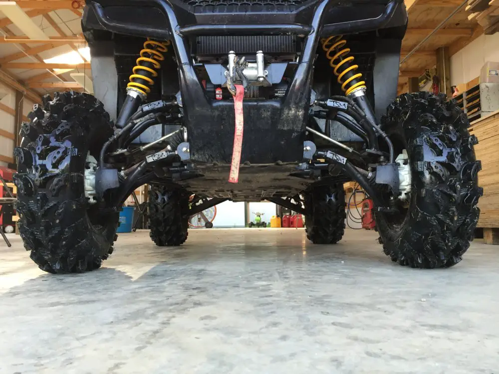

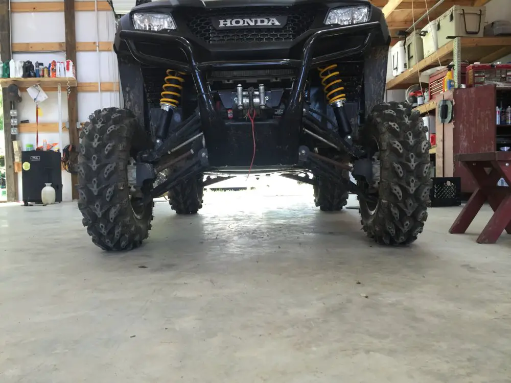

OK, I have the fronts done. I don't have photo with everything stock, but I did have one I took after the Can-am shocks were installed. They are much beefier than stock. I'm now clearing 16".
IMG 2342 IMG 2820 IMG 2819

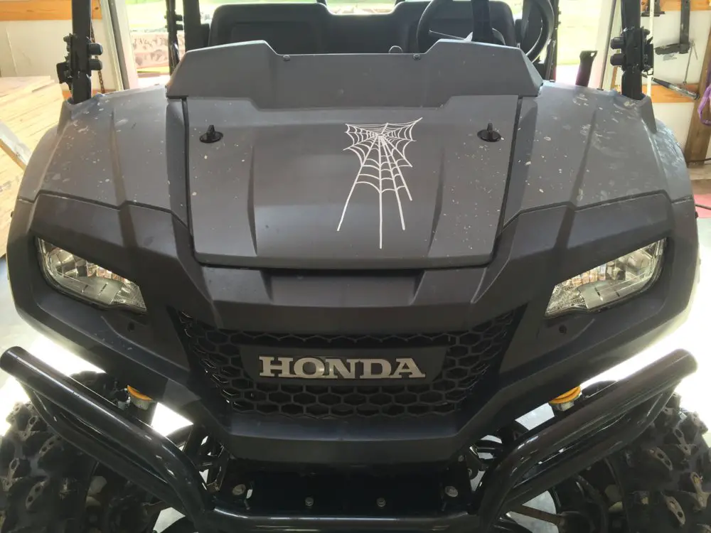

The wife wanted some bling so the spider web showed up. I might make her change it to black. IMG 2831

Are they forward arched?

Look good. Close ups please. So the back is still stock ?

I will buy new tires after we get the rears arched. Those are 28.5" Swamp Lites. They measure right at 28.5".
They are arched forward 1.5". If you go any farther the stock steering is compromised.
Paul's day job took him away. He will be back in about 6 weeks and we will do the backs.
I wish I had taken close ups. I'll see if I can blow one up and not loose resolutions.
IMG 2821 IMG 2823

I have no idea why that photo wants to lay sideways.
IMG 2831
Reactions: joeymt33

Thanks for the close ups, even though I had to lay on my side for the one lol. I really need that forward arm. Looking good.
