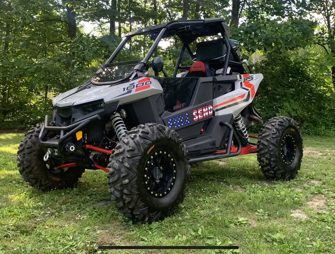

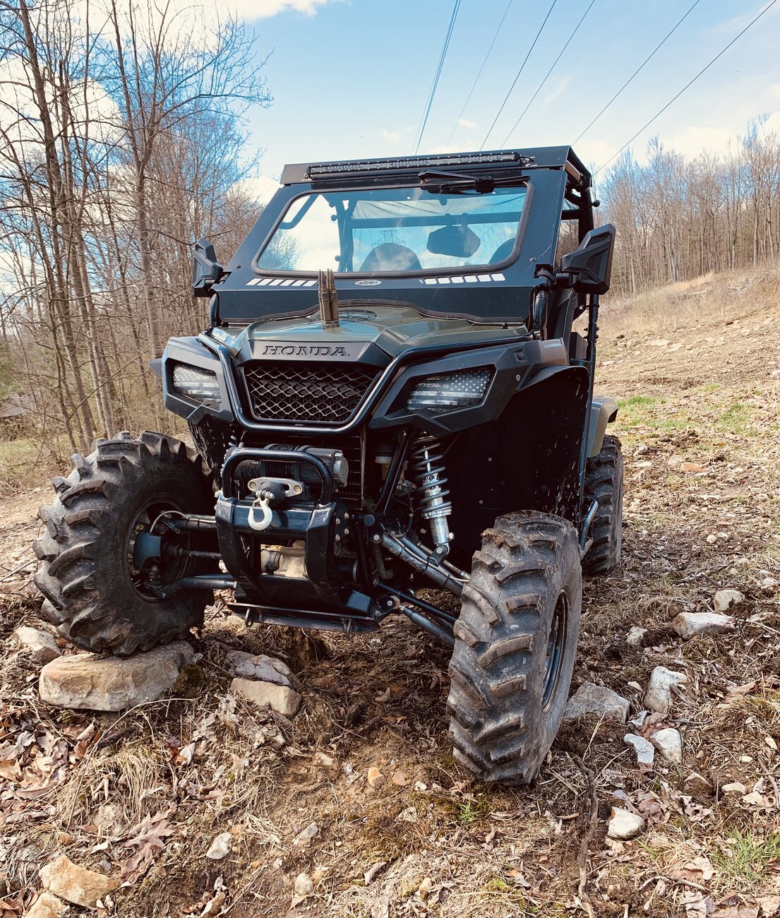

Well I ordered a pioneer 1000-3, dealer says Honda has been good at getting them quickly to them so I’m hoping. Ordered in a 3” bracket lift, and looking at ordering 30’s. Do anyone here run 30”x10’s on all 4 corners? Also id like for the tires to track each other, so I’d need to know where to add spacers (front or back) and what width. Lastly I ordered the base bc I normally like to mod my sxs’s how I see fit and the only thing I’d like to have that the deluxe has is the colored door and bed side panels. Anyone have a good source for these, I ordered the green. Pictured is my P5 with about 8k in aftermarket. Been a good little buggy that will be for sale soon! Also pictured is my RS1 I just sold
