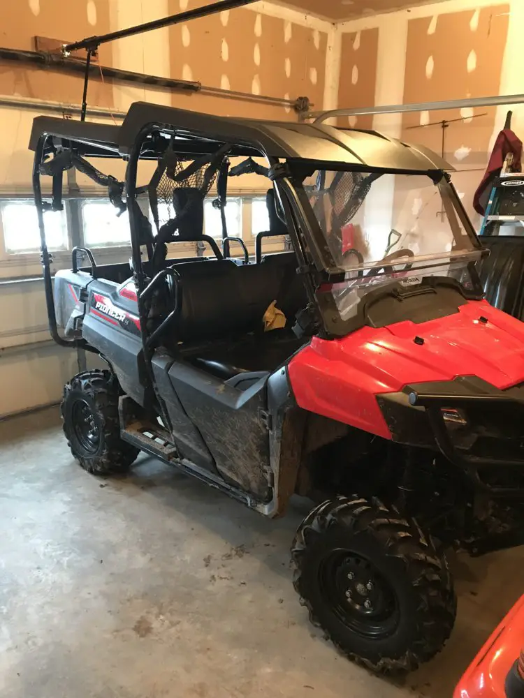

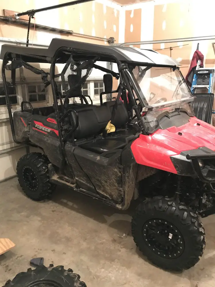

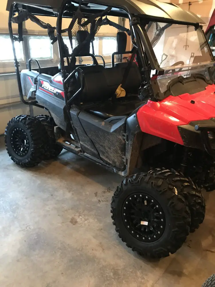

The wheels and tires came in today, got all of them mounted. I went with 14” tusk nebo wheels and sti Roctane tires. I put 26x11-14 on the rear and 26x9-14 on the front. The combo raised the pioneer 1 1/4” all together. I’ll try to take it for a ride tomorrow and report on how they handle. They do add some additional weight just by feel, not sure about any performance negatives yet. I will also post more pics later.

The ride will be better.

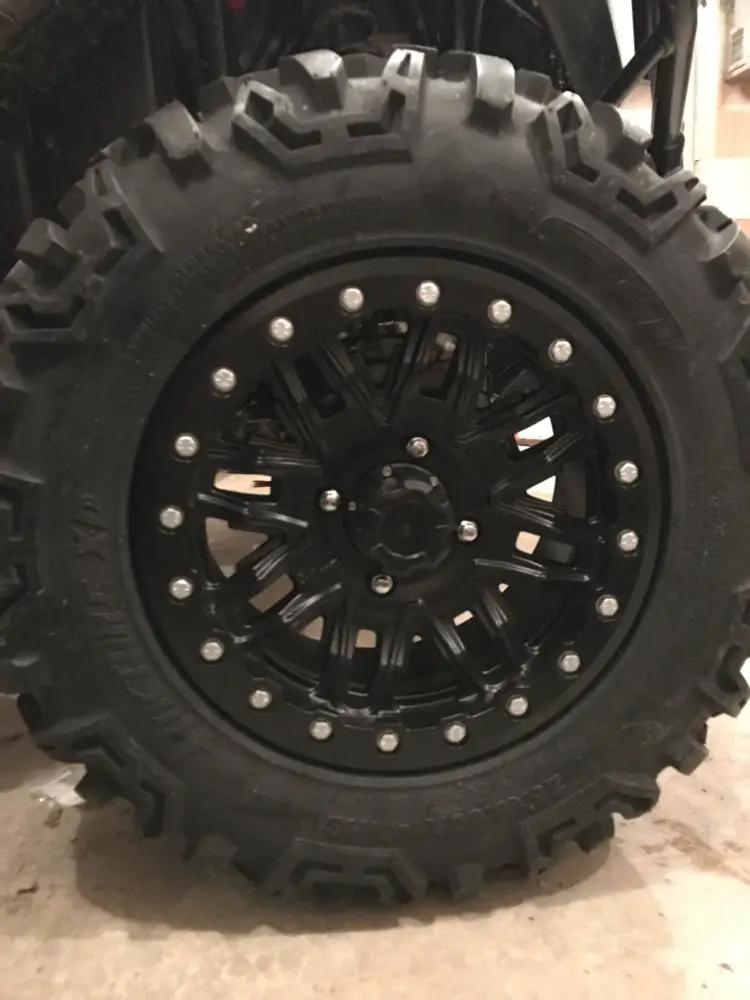

After some testing last weekend, I can say the Roctanes do very well in the mud. I need more snow to report on that. The 14” wheels with 26” tires ride good without any noticeable power loss. The tires make good contact and clean out well.

The tusk beadlocks are solid wheels but if you buy them, make sure they are torqued when they come in. I had 5 or 6 bolts noticeably backed out. It takes a little time to follow the pattern and tighten them all 10lbs and then 20lbs on 20 bolts per wheel.
