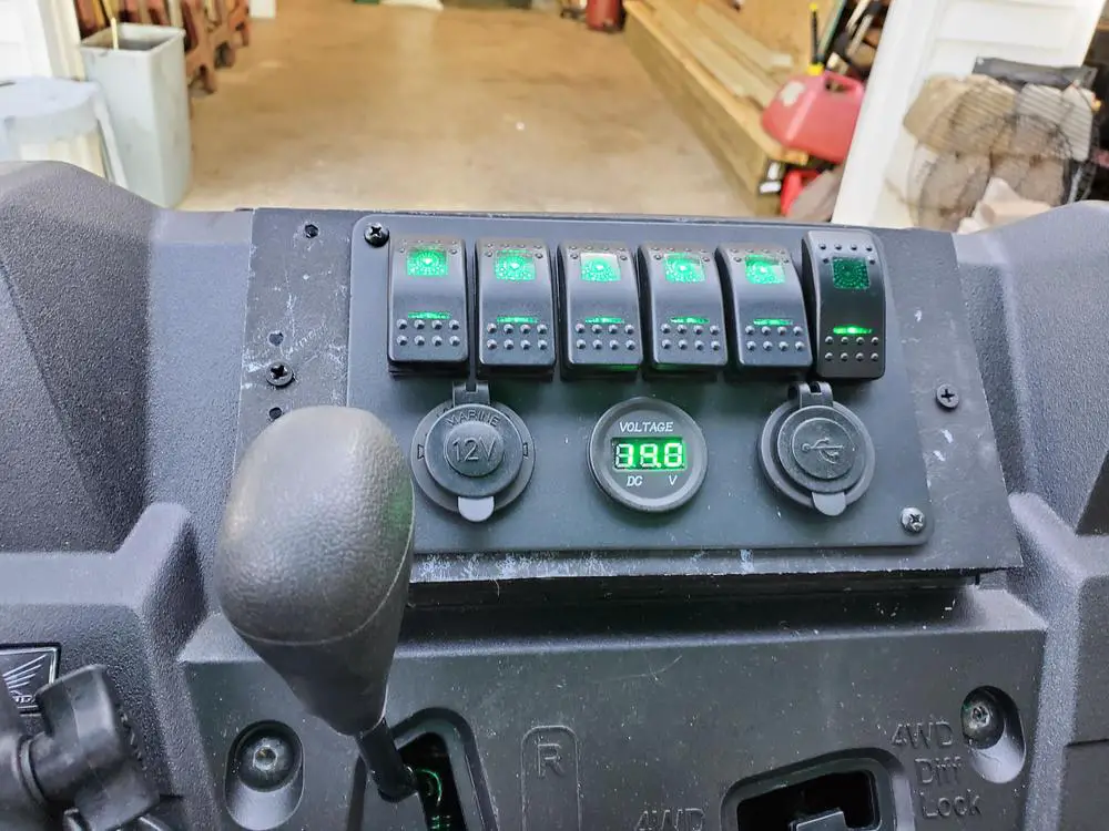

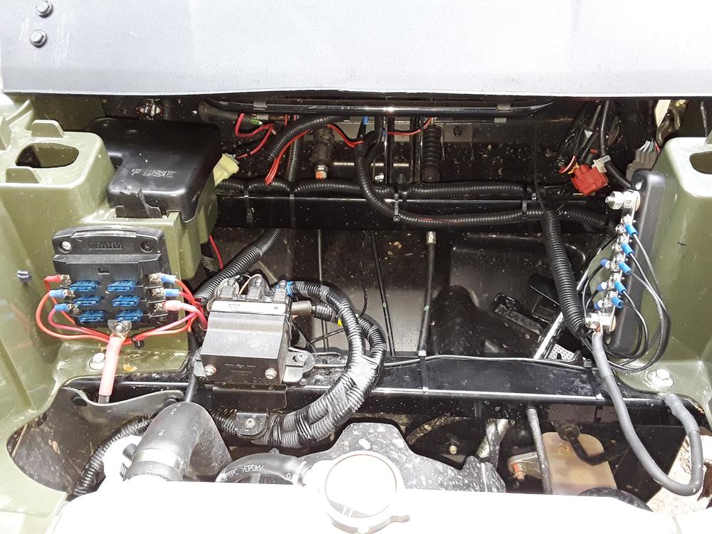

I know I'm late to the party but I added a 2nd fuse block and ground bus bar under my hood for all accessories to be fused and have power when the key is off.
Also installed a 6 switch panel to my dash for everything to run off of.
I ran a hot wire from the battery to the fuse block, then just grounded the bus bar to the radiator support.

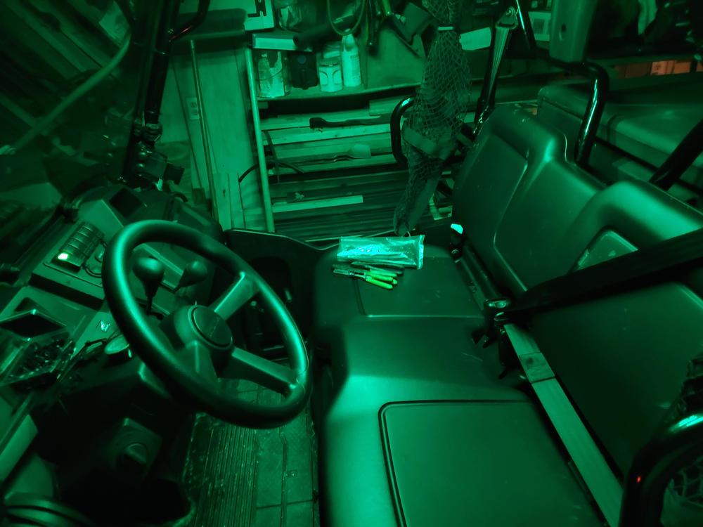

I'm now in the process of adding a 2nd battery just to run all the accessories. That's all that it will power is the 6 switches that have 2 led light bars and 2 sets of led pods. 1 set of interior lights and the 6th will power my stereo set up one day.

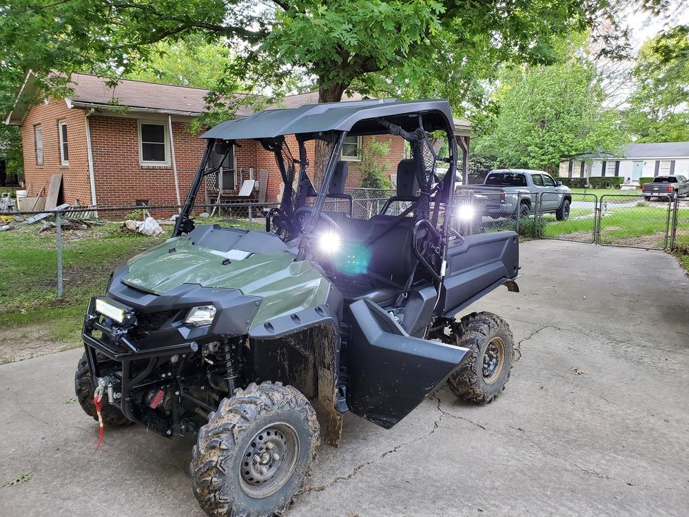

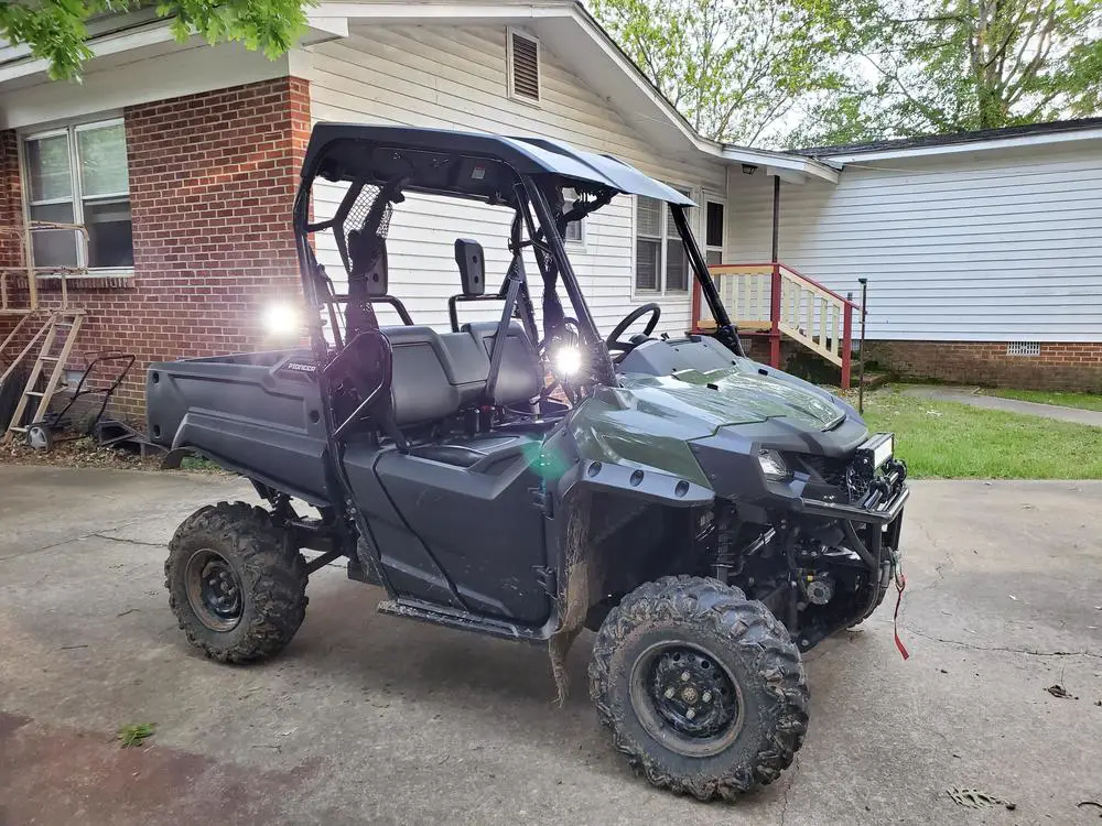

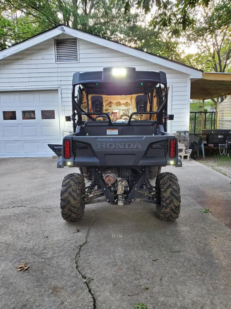

Also you might consider swapping out the head light bulbs to these, so much brighter than the factory bulbs and they are plug & play installation. View attachment 199350View attachment 199351View attachment 199352View attachment 199353View attachment 199354View attachment 199355View attachment 199356
