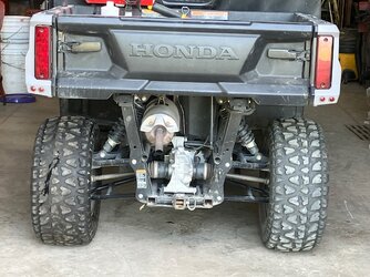

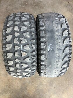

I do a lot of hard surfaced road driving between farms. This is the second set of rear tires on my P 520. Granted, I've got 7700 miles on the lil work horse, but the passenger rear tire wears twice as fast compared to the driver's side. I saved the original (factory) tire that was 1/2 wore out, figuring the 2nd set would probably wear the same. So I changed out the wore out passenger with the original 1/2 worn out tire to have a match set. Almost seems rear passenger side suspension needs more camber in the A-arms. A-arm bushings aren't worn out. Any other P 520 owners having the same issue? TIA

At first I was going to say over inflated but a closer look tells me I have no idea.

Been running 10 psi on all 4 corners. Still have the original front tires on it. Front tires are about due to be replaced.

If it was a front tire I would say check you toe in or out because they are notoriously bad but on the rear IDK.
